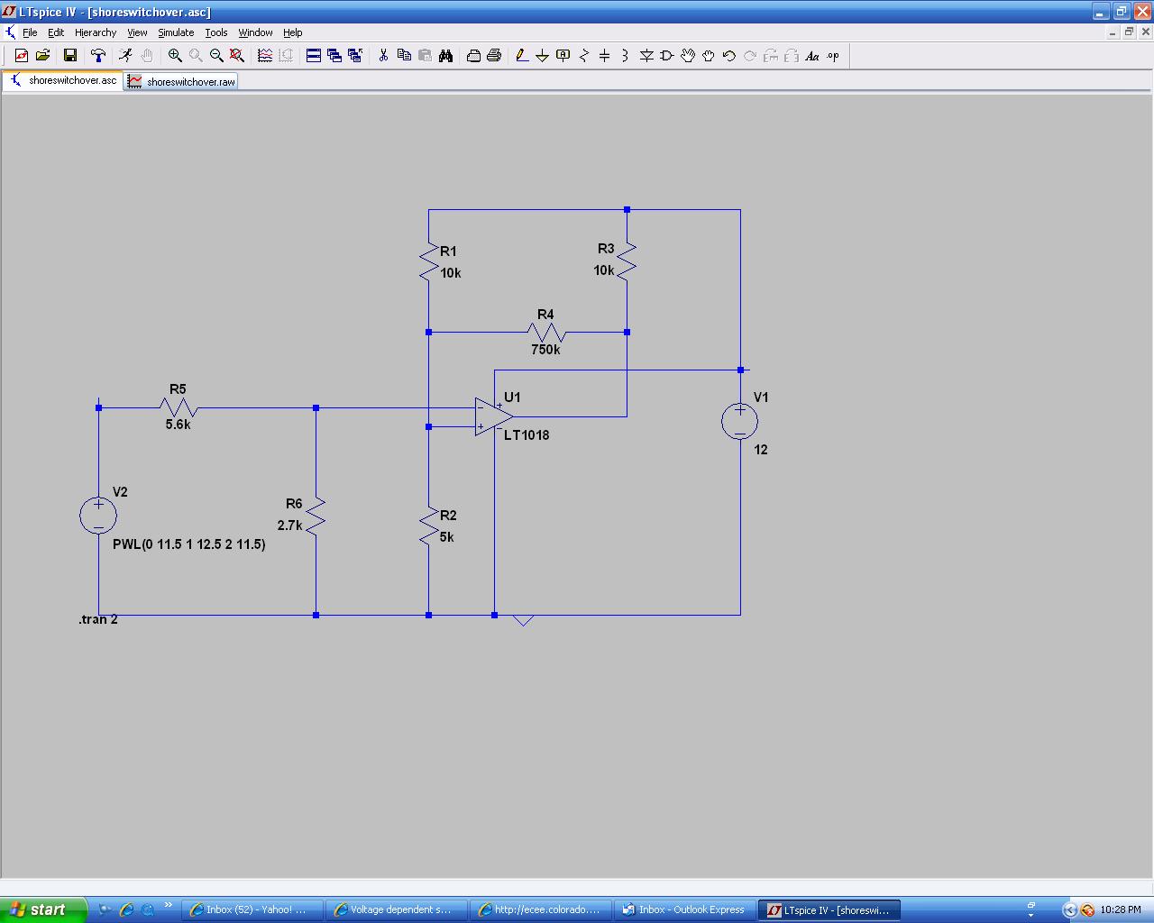

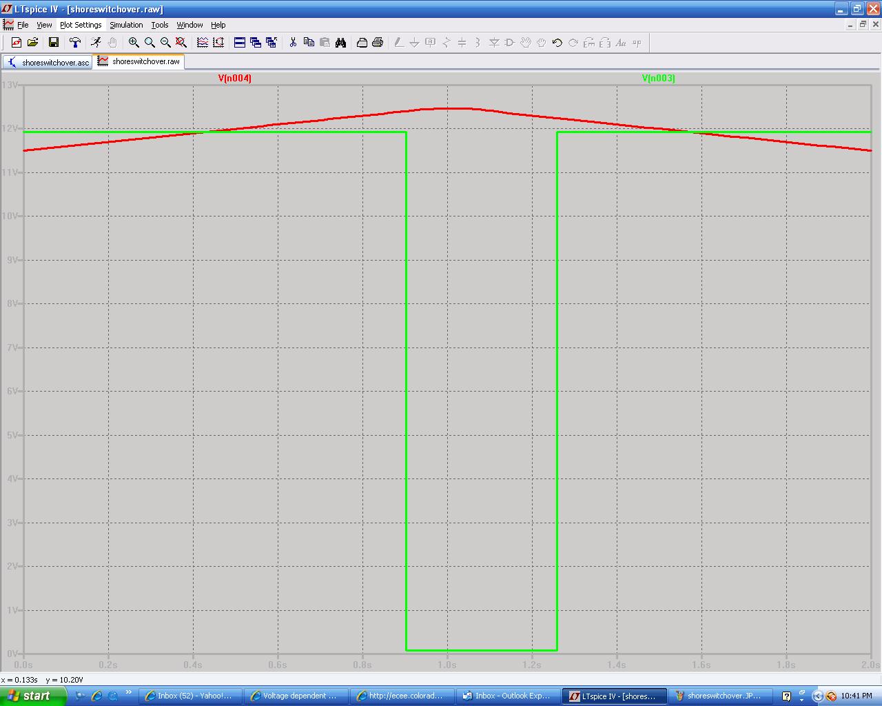

Here's essentially what you're looking at. The circuit requires a comparator and a few resistors. R6 will need to be a combination of a fixed resistor and a variable "trimmer" resistor to get the level set correctly. You'll need a steady source of power. You might use a wall plug in the 120V circuit, and with good bypass capacitor, around 10uF or so, it should work during switchover. To set the circuit up, you should use a variable voltage you can adjust to your desired trip point. To make one, just use a fixed DC voltage and a variable resistor connected across the voltage and connect the wiper to the circuit. Using a 10K variable resistor will ensure you won't have over current and blow it up. Oh BTW the actual comparator don't have to be the same. Use whatever will drive you actuator, I just grabbed one from the library. You'll probably need a transistor between the comparator and your relay, or whatever you're planning on using.

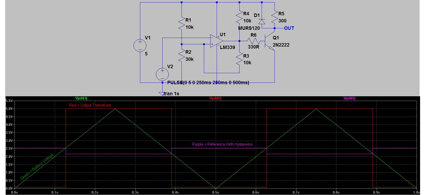

Attached is a variation of BrownOut's circuit that I made yesterday, It runs along the lines of what I mentioned in my post as to using a comparator. One big difference is I would likely power off a LM7805 regulator (not shown) to get a stable ref voltage. I also added some hysteresis. In my cartoon R1 and R2 would be replaced with a 10 K Ohm pot and adjusted for the output I mention above.
The output would eventually be used for switching between on board or shore based power. Everything would still need tweaked and peaked and designed around exactly what you want to happen and when.
Ron

My circuit also has hysteresis, provided by R4, though much less than Ron's. Be careful about having too much. You're looking at a voltage that changes by around 5-8% or so from fully charged to half charged. Too much hysteresis will prevent the comparator from working properly.
