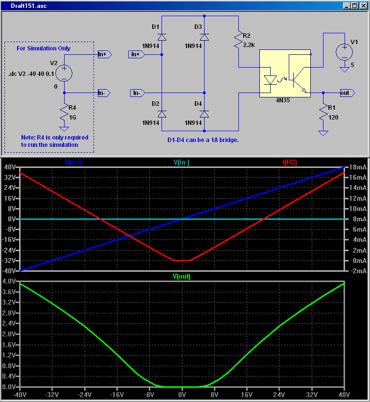

I am designing a circuit which need to be triggered by a random voltage and polarity.

i just need a trigger for the microcontroller. so the circuit will trigger the input of the microcontroller when a voltage of 12v, 30v or 40v is present.

Can the microprocessor ground pin be tied to the ground for the voltages being sensed? (If so, why not just use a uP with an A/D converter with a suitable resistive divider?)
no need to be precise... the user can connect and input of 12v to 40v and the circuit must still switch on... I cannot use an a/d as the polarity can be changed.. (the user can swap the wires of + and -)

Here is my hack at it: Use the A/D in the uC to read the voltage at Vout. Input is isolated from the uC's ground pin. You may have to adjust R1 to make V(out) to be ~4V when V(in)=40V.

Mike; That may work with an A/D input but not with an I/O pin. IF I was using an I/O pin I would use a constant current regulater feeding an optoisolater. Andy
The 4n35's output current is more or less proportional to (vin-4). If he uses an A/D, he can roughly measure a voltage range between ~±10V and ±40V. If he wants just a single ±trip point, then run V(out) into a comparator (either external or internal to the uC).

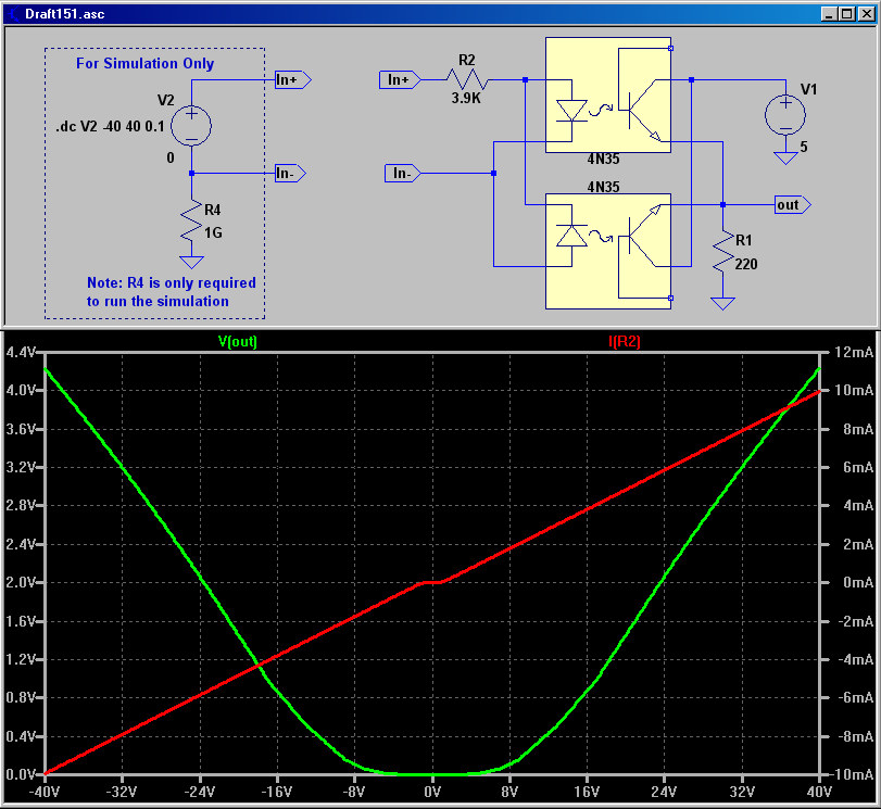

I'd use a pair of opto couplers: 1 for each polarity and wire OR the outputs. Feed the inputs thru a blocking diode then thru current limiting resistors to a ~10V zener then another CL resistor to the opto. Size the CLs for reliable op at lowest input and the zener to have enough current headroom to handle highest from there. <<<)))

Even simpler:
