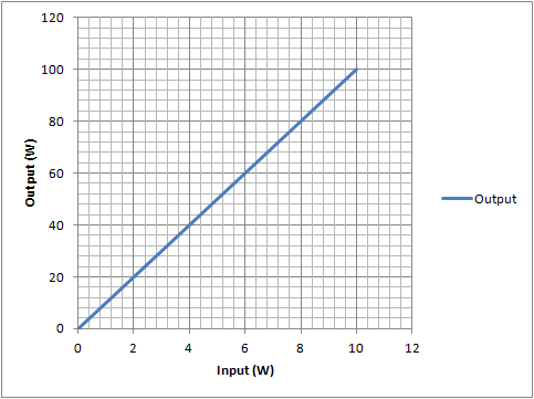

Lets say we have a transmitter with 10 Watts output, and we need 100 Watts out.
We can add an external amplifier which has a gain of 10.
If we test this external amplifier, by putting various amount of power to the input, and measuring the output and get results like this:
Input (W) 1 2 3 4 5 6 7 8 9 10
Output(W) 10 20 30 40 50 60 70 80 90 100
And plot a graph:
we have a linear amplifier.

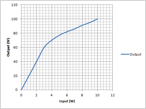

But, if we get results like this:
Output(W) 20 40 60 70 77 82 86 91 95 100
And plot a graph:
This is a non-linear amplifier.

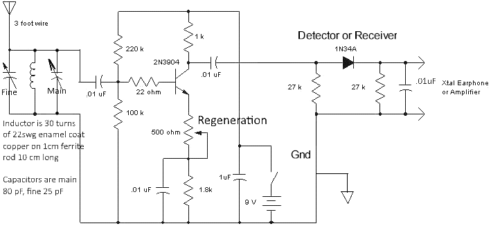

To return to the circuit I posted at the beginning of this post of an RF transistor amplifier, the collector resistor has a value of 1 k ohms. The emitter has a potentiometer which is 500 ohms, but when the radio works best this pot is set at 20 ohms. If we assume a collector current of 2 mA and agree that the emitter current is the same (2 mA), then the voltage drop across the collector resistor would be 2 volts and the voltage drop across the emitter resistor would be 0.04 volts. To find the gain for this circuit we could divide the 2 by 0.04. This would give a gain of 50.
Does that all follow, and would that be the actual gain that I would achieve in this circuit?
And what if I was to reduce the emitter resistor to say 10 ohms? Would that double the voltage gain to 100?

What I am very greatly interested in is how to amplify microwatts or nanowatts of incoming RF in my crystal radio. I have a tuning circuit set up to deliver roughly 1000 kHz to my amplifier stage. I have a 9 volt battery and I want to use a 2N3904 NPN transistor. The circuit is drawn on the first posting way above but can be seen here.
I am new to forums and their conventions. Should I start a new posting for this topic?
In theory - but regeneration is actually positive feedback - like negative feedback, but used to increase the gain. If you increase it too far the circuit will oscillate, but if you increase it 'just' before oscillation starts you get the maximum possible gain from the circuit - also the lowest possible quality of course.
But it's not a crystal radio anyway, as it has an RF amplifier stage, followed by a detector stage.

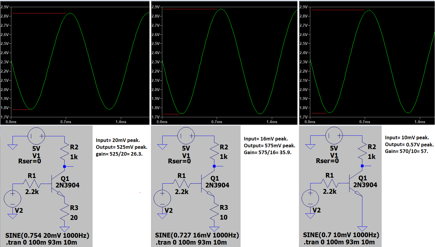

The gain will not be 100, 50 or 100 because the transistor has a resistance at its emitter when it was made. Its resistance is 0.026/Ie which is 13 ohms at 2mA.
So the gain with your 20 ohms emitter resistor is about 1k/(20+13)= 30.3, with your 10 ohms the gain would be anout 1k/(10+13)= 43.5.
This is when the transistor circuit has no load because a load reduces the output level.
I simulated the gain at 1kHz. The gain will be less at radio frequencies.
