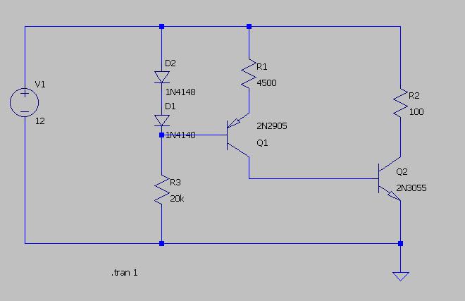

think of the transistor as a lever, and beta as the ratio of the distances of the ends to the fulcrum. if the base end of the lever is 100in, and the collector end of the lever is 1 in, the ratio is 100:1. pushing up on the base with 1lb of force will pull down the collector end with 100lb of force.
measuring the beta is simple with a constant current source. you set a constant current source at, let's say 100uA, and feed it into the base of the transistor, then measure the resulting collector current.
so here's a beta tester. the base current on Q2 is 100uA, the collector current result is 7.2mA when the sim is run, so the beta is 72.
the current source part of the circuit is Q1, D1, D2, R1, R2. R1 sets the current, and that current should be equal to the voltage across D2 divided by the resistance of R1. because of variations in the Vf of diode and transistor junctions, the value of R1 should be determined experimentally.
i ran it here as a sim, but with real components it works the same. even with the sim, i had to play with the value of R1 to get 100uA. with real components, a DMM from Q1 collector to ground in current mode, and without Q2 in circuit is suitable for measuring the source current. Collector current in Q2 is determined by measuring the voltage drop across R2
that depends on the particular Vf of the transistor 0.5-0.8V is the usual range for silicon. 1.0-1.6V for silicon darlingtons. for germanium, the Vf is 0.1-0.4V. other transistor types (there are a lot of new types, such as SiC and SiGe) will have different Vf bias voltages. the beauty of the current source is that it doesn't care what the Vf is, it supplies the same amount of current regardless.
