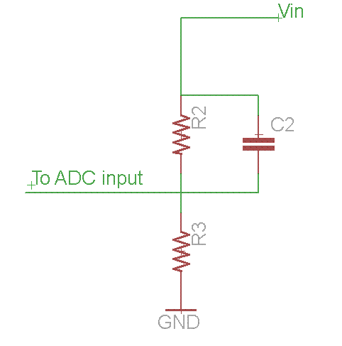

I am trying to build a mixed mode logic analyzer / scope.
Only one of four inputs is wired to an ADC. i want to be able to sample signals ranging from 0 to 24 VDC, using a 5V ADC. That's why i need to lower the voltage to 5VDC using a voltage divider.
Is this the correct way to add the compensation capacitor on the voltage divider?

Yes, but you probably need to add a capacitor across the bottom resistor as well, to 'swamp' the stray capacitance.
Scope probes don't do that. It just increases the capacitance load of the probe. Why would you do that here? The stray capacitance is fairly constant. You just need an adjustable capacitor to optimize the compensation.
Have a look inside a scope, at all the capacitors across the input attenuator.

I tried the configuration above and observed the result on a scope:
I injected a 20MHz sine wave on the input of that divider, with a 27 pF cap.
Without the cap, everything seems OK, the voltage at the central node is half the input signal.
When i add the cap, it seems like due to the high frequency, the voltage at the input decreases, and the voltage at the node become higher than the voltage at the input. As if the cap become a short circuit in high frequency. Well, at least that confirmed what i studied! Maybe the solution was to add another cap on the bottom resistor..?
You can't just add a random capacitor, it has to be EXACTLY related to the capacitance at the bottom and the attenuator values - which is why it MUST be adjustable.
