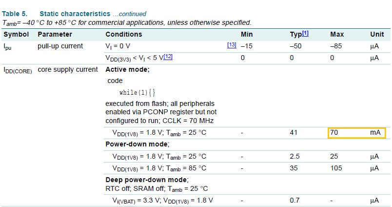

awesome thanks so doing that and using 1/4w wouls be
1/4 * 1/1.5 = 167mA (rounded up)
Awesome. That way more than enough.
So i uploaded a picture of the info it stated 70mA max
max-jpg.48036
you think a 10mA cushion is fine?
At 70mA, a voltage divider would make a poor regulator. You can use the zener, but you should buffer it with an opamp, or else just use a 1.8V regulator. Otherwise, you can use a zener and resistor voltage divider, but make sure you have some spare current delivered from the resistor ( ie, (5 - 1.8)/R > 70mA ), and that no max power spec is violated.
Regulators are cheap. Your time spent debugging flaky circuits is not. I would stick with off the shelf regulators.
3.3 - 1.8 = 1.5
1.5 / 20 = 75mA
1.5 / 15 = 100mA
So a value between 15-20ohm is best correct?
Careful, 1.5V*100mA = 150mW, so use 1/4 watt resistors, at least. Also, the power in your zener will be 1.8V * (100mA - 70mA) = 54mW average. If the uC were to become disconnected, then you have, for the zener 100mA*1.8V = 180mW. Always make sure you're spec'd for enough power.

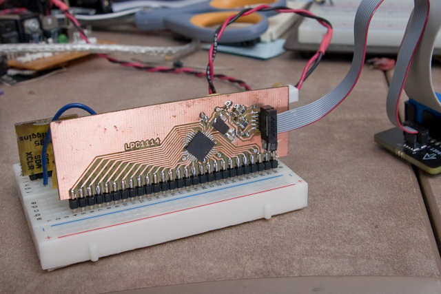

I've gone through a few manufacturers, but I'm basically sticking with the LPC1xxx chips. Mostly the LPC1313 (Cortex-M3) and LPC1114 (Cortex-M0). Unfortunately you need to go up to the LPC17xx devices to be able to use regular JTAG. I don't know what there is for SWD options out there right now, but I'm using an SWD adapter from Rowley on my Olimex AMR-USB-TINY JTAG. I think finding a decent SWD programmer will be the hardest.
The M3 and M0 parts are nice. Fast, 100Mhz, 72Mhz, and 50Mhz. Cheap for the LPC13xx and LPC11xx parts, down to $2 for 8k LPC11xx parts from NA suppliers. The LPC17xx are the 100Mhz do it all parts with all the crazy peripherals like Ethernet and they get close to ARM7 prices $6 to $12 for NA distributors.
Simpler to program, the peripherals, at least on the SAM7 chips I used were crazy. My SPI library was nutty. The cortex chips are meant to be simpler and the LPC13xx CM3 and LPC11xx CM0 have compatible peripherals mostly, so I don't have different libraries for both.
Simpler hardware. Just power and a crystal oscillator. No external PLL or need to power the VCORE yourself. I can actually put one on a single sided board with a minimum of jumpers. The SWD connector is a much smaller connector, though I think I'll be moving from the standard header to a 4 pin header. The little SWD connector are expensive and I really don't need them.
