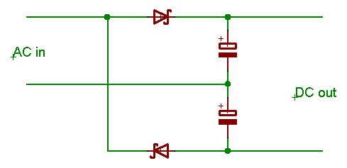

i would like to power up a system which need 3.7V dc and 350mA.
Now, i have an input of 2V,can i use a voltage doubler to power up the system??
If cant,any solution to this problem?

i forgot to mention,the input is 2V ac
So a bridge rectifier will get you 2.8 Volts DC and you will still need a low voltage DC-DC converter with all the same problems mentioned by bountyhunter. Where is the cockamamie requiremnt coming from?
So how about a 1:1.5 stepup transformer that gets you to 3VAC, a bridge rectifier gets you 4.24VDC and a 3-terminal LDO that brings it back to 3.7VDC -- simple and straightforward - eh?
Two half wave rectifiers on opposite half cycles will get him 5V with schottky diodes.
The one I'm thinking of gives ±2.5V either side of one of the AC lines. See attached.
