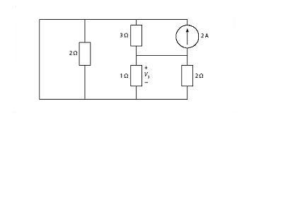

Hi All,
I'm a new learner in Electronic and the attached is my exercise question which required your help.
Please find the voltage drop across the 1 Ohm resistor.
Thanks in advance.

All the resistors are connected in parallel.
Work out the total resistance using the resistors in parallel formula.
Calculate the voltage across all the resistors using Ohm's law.
Hint: one of the resistors is short circuit and will have no voltage across it and therefor no current flow.

Combine the 2 and 1 Ohm resistors into an equivalent resistance. Redraw the circuit noting that a wire that shorts across a resistor eliminates it from consideration. You will find the current source has two separate resistances across it. Combine them for an equiv resistance and then calculate the voltage caused by 2A of current.

Try this: designate the long wire that wraps around the outside of the schematic as ground and then redraw the schematic. One side of the current source connects to the ground line, one side of every resistor connects to ground. I believe you will see how the current source is connected across all the resistors in parallel. You will also notice one of the resistors is connected to two different points of the ground line, so it has no current through it and can be eliminated.

I've redrawn it for you.
Note that the signs across the resistor are opposite to the supply so the voltage will b negative. Don't allow this to confuse you, just put a - sign in front of your answer.:D

What happened to the 1 Ohm parallel the lower right hand 2 Ohm?
there is a series/parallel combo of 2 + (1//2) = 2 + (2/3) = 2.6666 Ohm, that should parallel your 3 Ohm and the source?
It has a wire across it so it effectively disappears.

What happens if you connect a DVM up with the - input to the positive supply and the + input to the negative supply? It displays a negative voltage.
The signs on the circuit have been put this way to make you think.
2) Add series of left hand 2 Ohm and combo 2/3 Ohm (1 parallel 2) = 2.666 Ohm
You're not listening, the left hand 2Ω resistor has a piece of wire across it so its resistance is 0Ω.
The voltage across the 2Ω resistor will be 0V.

That's wrong.
The resistances are all in parallel, I'm not going to say this again.
