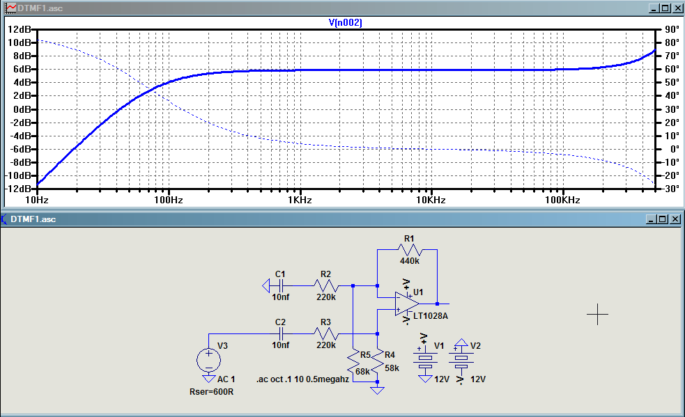

hi dramrattan,
This is your cct with a gain of 2, [6dB], I have used a single ended input for demo.
The 3dB point is about 70Hz.
What did you use to simulate the circuit?...How do yo know the gain is 2 from that graph? :eek:
LTSpice.
The gain 6dB, look at the left Y axis of the graph at the 0bB line, the flat portion of the gain curve is on the +6dB line... OK.?
