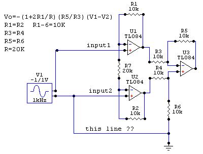

I don't believe there is any danger of damage to the transformer. You do not want to build the digital voltmeter, but the AC/DC converter of Figure 2 of An-202 will be useful. The output if that circuit will be input to the ADC. The differential amp is good, the load on the transformer is small, if that is what you want. C1 is not needed but a capacitor at the output of the diff amp would be a good idea.

Digital voltmeters have limited common mode range; they cannot measure a voltage that comes too close to the power supply voltage. If you use plus and minus power supply voltage, ground will not be a problem. One of the voltmeter inputs can be ground, the other will be the DC voltage.

Does anyone know why using this design, and no signals at input I see with an oscilloscope (in real life) a signal of more that 8 volts at a frequency of 60 Hz)
I am feeding the TL084 with +/-9 volts. and I do not know why in the simulation using circuit maker I have to put a line from the coming signal to the ground, without it the simulation does not run?
What do I have to do with in real life?
