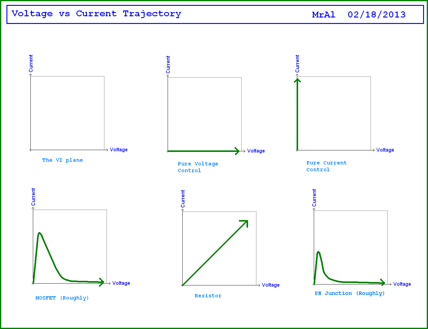

Hello,
Read your own words, first paragraph. If something was PURELY voltage controlled, then you would not have had to say that. By saying what you have in this thread, you are implying that everything is voltage controlled because it doesnt matter if it also needs current it's still voltage controlled. But the mere measurement of a parameter doesnt make it the controlling parameter.
What i am stating on the other hand is that everything needs both voltage and current, and so more concisely there is a V I trajectory for every device (see attachment). To fully explain the device we need to know this information.
MrAl,
I think you are making your remarks to me. I always try to name the person to whom I am talking.
I see no dichotomy in what I said with regard to voltage control causing current (notice I said just "current", not "current flow"). You have to distinguish between control causation (voltage) and consequence (current). Just because current is a consequence of voltage does not mean that current is controlling something.
And so what if there is both voltage and current in a device that can be plotted. I said before that you cannot determine what is controlling a device by graphs, equations, or measurments. You have to know the physics of the device to find out that information. For semiconductors, the physics point to the energy concentration per unit charge (voltage=joules/coulomb) that controls the device.
Ratch
MrAl,
Ratch
<still editing for format>
Hello again,
"I see no dichotomy in what I said with regard to voltage control causing current (notice I said just "current", not "current flow").
does not mean that current is controlling something."
That's an interesting statement. You are stating the current is a consequence of voltage, but that's only true in a separate circuit
apart from the 'voltage'. Since that's not always the case, and when we want to know how a device is 'operated', we want to talk about
the voltage and current in the SAME circuit. Let me try to make this a little more clear.
When we energize say a gate, we are trying to control the transistor. Once we establish a voltage, we see drain source current flow.
But the whole idea behind control is what are the signals that we are applying TO THE CONTROL terminal to get that control, not just
some random signals that exist in other places in the device.
So the whole point is what is going on with the control signal itself. And in order to drive the device we have to apply both current
and voltage, because here is no way to apply a voltage from out of nowhere to a device.
"And so what if there is both voltage and current in a device that can be plotted. I said before that you cannot determine what is
semiconductors, the physics point to the energy concentration per unit charge (voltage=joules/coulomb) that controls the device."
I did not create the graph and then looked at the physics, i looked at the physics first and then came up with the graph. That graph
shows how EVERY device behaves with respect to current and voltage, even if you could somehow prove that a device could be totally
voltage controlled (pure voltage control is shown along the x axis). Trying to void that graph is the same as voiding your own
statement that something can be purely voltage controlled because pure voltage control appears along the x axis. You're also trying to
void many devices that exists because that graph represents all devices that are voltage or current controlled (if they could exist
alone) and anything in between (except negative polarity signals were left out for simpliciy).
You're also now stating that it is in fact the energy that makes the difference, but still claiming that voltage is the controller and
even typed out a little formula for the voltage to emphasize this :-)
The circuit you seem to be working with is a totally fictious circuit in every sense of the word. You've somehow managed to get a
voltage to appear somewhere you wanted it to be without moving any charge. I'd like to see how you did this :-)
This is why the transistor is sometimes also quoted as being "Charge Controlled". In this scenario the movement of charges controls
the device. But we all know you cant move a charge without energy, and energy cant come from voltage or current alone but requires
both.
So back to your statement, "current is a consequence of voltage". Since the movement of charge is the only way to establish a voltage
in the same circuit loop, any voltage that we apply has to come through wires and so there has to be movement of charge just to get
that voltage there, which means charge has to move though the wires as the voltage is climbing.
So when we try to get to the "underlying physics", we would like to know the most basic physical principles at work, not some super
shelf where it looks like something else is happening.

I do not disregard the graphs if you are talking about design. I do consider them irrelevant for determining control. A good example is the Ib-Ic graph for a BJT. That graph is good for design, but it does not tell you that a BJT is voltage controlled.
You're also now stating that it is in fact the energy that makes the difference, but still claiming that voltage is the controller and even typed out a little formula for the voltage to emphasize this :-)
You are misquoting me. I said that the energy concentration (voltage) is what controls a semiconductor.
The circuit you seem to be working with is a totally fictious circuit in every sense of the word. You've somehow managed to get a voltage to appear somewhere you wanted it to be without moving any charge. I'd like to see how you did this :-)
I never designated any circuit or schematic. The voltage will appear wherever the input signal is applied. I said several times now that current may accompany the voltage, but it does not control the semiconductor.
This is why the transistor is sometimes also quoted as being "Charge Controlled". In this scenario the movement of charges controls the device. But we all know you cant move a charge without energy, and energy cant come from voltage or current alone but requires both.
And the "sometimes" pertains to nonlinear switching circuits where turn-on and turn-off transients come into play. This is not applicable to the active region region which is voltage controlled.
So back to your statement, "current is a consequence of voltage". Since the movement of charge is the only way to establish a voltage in the same circuit loop, any voltage that we apply has to come through wires and so there has to be movement of charge just to get that voltage there, which means charge has to move though the wires as the voltage is climbing.
Charge movement is going to occur from the region of higher energy concentration (voltage) to the region of lower energy concentration. The signal voltage is going to establish the voltage to do this. Charge is not going to move by itself. But all this is irrelevant with respect to what is controlling the semiconductor.
