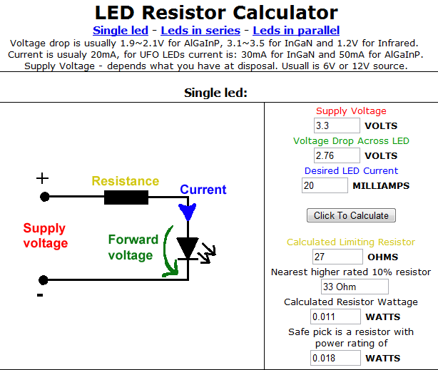

Then I found this site:
LED Resistor Calculator
Attached are the results of their calculator. 27 ohms.
The calculation they use on their site is:
(Vs - Vf) / (mA / 1000)
so (3.3-2.76) / (20 / 1000)
so 0.54 / 0.002 = 27 ohms
So would the correct way to calculate the current and resistance be?:
"Blue LED
- Source voltage Vs = 3.3 volts
- Forward voltage Vf = 2.76 volts
- Desired current = 20mA (0.02A)
- Calculated resistance required:
-> Vs-Vf = 0.54V
-> Ohm's law is R = V / I
-> R = 0.54 / 0.02
-> R = 27 ohms
- nearest available resistor: 33 ohms
- Calculated actual current (I):
-> Ohm's law is I = V / R
-> I = 0.54 / 33
-> I = 16.36mA
- actual resistor used: 100 ohms
-> Ohm's law is I = V / Ra
-> I = 0.54 / 100
-> I = 5.4mA"

Thanks very much for the feedback. Any chance you could check out my working out:
...I found this site:
LED Resistor Calculator... the results of their calculator was 27 ohms.
"Blue LED
-> Vs-Vf = 0.54V
-> R = 0.54 / 0.02
-> R = 27 ohms
-> I = 0.54 / 33
-> I = 16.36mA
-> I = 0.54 / 100
-> I = 5.4mA"

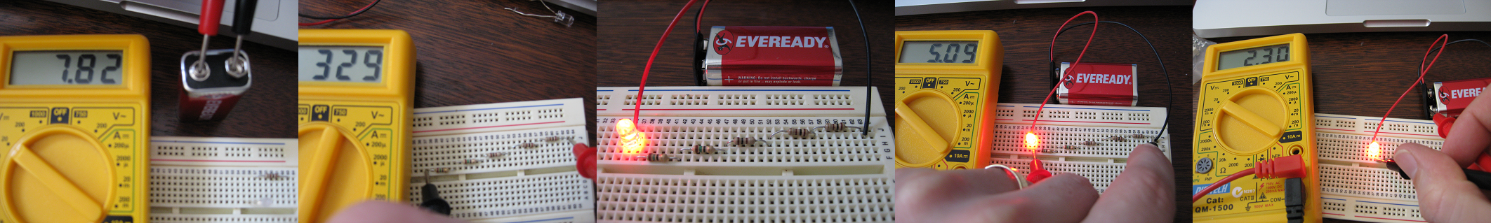

Nobody makes an LED with a forward voltage drop of 2.76V. They make LEDs with a range of voltages so you don't know what is the forward voltage of your LED unless you measure it. It might not light with only 3.3V. The range might be from 2.5V to 3.5V. If it is actually only 2.5V and you use a supply of 3.3V and a 27 ohm current-limiting resistor then the current is (3.3V - 2.5V)/27 ohms= 29.6mA and the LED might burn out.
Ahhh....
So basically I've still got it wrong because the blue LED probably has a different forward voltage to what I measured, and I'm supplying too little voltage to drive this circuit.
What I'd need to do, is start again say with 5V, or 9V source, and build a new circuit.
To test the forward voltage:
1) take the supply voltage source, measure it with a multimeter. say it measures 8.5V
2) take the LED, attach the positive lead to the positive of the supply voltage source and one to a probe of the multimeter and the other multimeter probe to the negative of the supply voltage source. the measurement will show the source voltage less the voltage drop of the LED. say it read 5.2V.
3) subtract measurement 2) from measurement 1), leaving the correct voltage drop of the LED. this would give say 3.3V.
Then to calculate the resistor required for 1 LED:
1) say the LED can operate at 20mA, to calculate the current limiting resistor required you would:
a) Calculate the voltage drop of the resistor in the circuit by subtracting the forward voltage drop of the LED Vf from the supply voltage Vs. Say 8.5Vs - 3.3Vf = 5.2Vresistor.
b) Knowing the current required and the voltage across the resistor, you can then use Ohm's law to derive the resistor value. R = V/I. So R=5.2/(20mA/1000). So R=5.2/0.02. So R=260 ohms.
Is that right?
I think I need to split up my blog post into two - one about v regs and another about LEDs and current limiting resistors (using a higher voltage source!).
Also, what if you have three LEDs in parallel with different forward voltage drops? How would you calculate the resistors required then? (say with a red, orange and green traffic light that would light up one LED at a time)

Breadboard Experiment
alright, here's what I've done:
1) Measure the voltage output from my 9V battery (after a bit of wear and tear) source = 7.82Vs
2) Built myself a 330 ohm resistor out of three 100 ohms and two 16 ohms in series :)
3) Plugged in an LED in series with the 330 ohm resistor
4) Measured the voltage across the 330 ohm resistor = 5.09Vresistor
5) Measured the voltage across the LED = 2.3Vled
(see attached pictures of each step and the measurements)
So to calculate the current in the circuit I'd use:
I = Vresistor / R
so I = 5.09 / 330
so I = 0.0154A
so I = 15.4mA
If I've got this far OK, would you give me some hints about how to work out the current in a circuit with three different LED colours all lit up at once? Say a red, green and orange LED? Also, how would it work if you had a program run through the traffic light sequence - lighting up each LED in turn to simulate a real traffic light - would the other LEDs affect the brightness of each other as they turned on or off?
