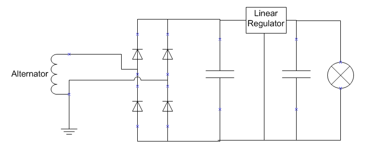

I'd like a diagram for a voltage regulator, 6 volt AC, to go on a small motorbike's taillight-only circuit. With no regulator, the taillight keeps burning out when I'm at max speed. Headlight is ok though.
Bike is a 1965 Sears/Gilera 106cc, that has AC electrics with no battery and no regulator. No DC current at all.
There are two coils;
1) Powers the headlight and the horn.
2) Powers the ignition coil, and the taillight.
Powering the tailight off the ignition circuit was common on antique Italian mopeds, for unknown reasons. Whenever the brake light burns out, the ignition goes to ground and stops the engine.
I found this circuit, but it's too complicated for my small bike. I'd like something simpler, more compact. Any ideas?

You can use a full wave rectifier to create a DC-link, as long as the bulb can be isolated from the chassis ground.
basically you use the supply from your alternator and the chassis ground reference as the inputs to your bridge rectifier. and this will give you a floating DC voltage, its very important that this DC voltage (positive or negative) shouldn't connect to the chassis or alternator supply at any point (I'd suggest fusing the input to the rectifier).
use a big capacitor to smooth the ripple and then a chopper or SMPS or LDO to drop the voltage as required.

I didn't say anything about using an LED and you wouldn't need a battery unless you wanted it to work without the engine on.
With a DC voltage you would just need a 6V or 12 bulb, you could probably use the existing one. The capacitor and Linear regulator would sort out any peaks.
So again all you need is a small 4A rectifier, an electrolytic capacitor and some kind of regulator (switch mode with no heatsink or linear with a heatsink)

circuit diagram to make it extra clear how simple you could make this.
KISS
