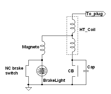

I'm joining the party rather late, but here's another hypothesis re the brake-light/ignition wiring.
1) There's an error in that linked wiring diagram: the left end of the top coil in the magneto is incorrectly shown grounded.
2) The brake switch is a normally-closed type, so that without the brake applied, the brake-light is bypassed.
3) Applying the brake opens the switch, placing the light in series with the HT_coil primary. Both light and ignition operate (albeit with a weaker spark).
4) If the light fails open-circuit (most likely), the ignition can still operate provided the brake is not applied.
I hate typical vehicle wiring diagrams, so I've redrawn the relevant part as I think it could be in this scenario (at least, so it makes sense to me) :
That said, I think it more likely that the brake switch is a normally-open type (perhaps the OP can confirm that?) and that the wiring diagram error is that the feed to the HT_coil primary should be taken from the opposite end of the magneto top coil from that shown. However, I don't see then how an open-circuit light would prevent operation of the ignition?

The functon is 100% clearer in this PDF. The lamps primary function is to act as a "ballast resistor". Used in cars so that after starting, the resistor is used as to stop pitting. To get a higher voltage during starting, the resistor/lamp is switched out. They also show the #of turns higher for the coil/points.

The stop lamp acts as a ballast. Here's a few resources.

I agree that the second diagram is much clearer. However, IMO it also supports my hypothesis that the brake switch is a normally-closed (NC) type. That would mean the brake light only acts as a ballast resistor when the brake is applied. Can the OP confirm if the switch type is NC or NO ?
I don't believe the bulb filament resistance has any significant voltage-regulating effect. What is regulated (approximately) though, is the current through the ignition coil primary, because as the rpm increases the magneto voltage increases but so does the AC frequency and hence the reactances of the primary coil inductance and the magneto coil inductance. Simulation confirms this regulation.

The brake light turns on, when the brake light switch "OPENS", so it's "protecting" under low RPM conditions. Meaning limiting the current and acting as a fuse.

When starting, the brakes are not applied, so there is no ballast, which again, makes a lot of sense.
I checked, the wire going to the brake light is normally grounded. When the brake is applied, the ground is broken. Does this help?
Yes; we now have confirmation that the switch is the NC type. It follows that, until the brake is applied, there is no ballast resistor in circuit.
