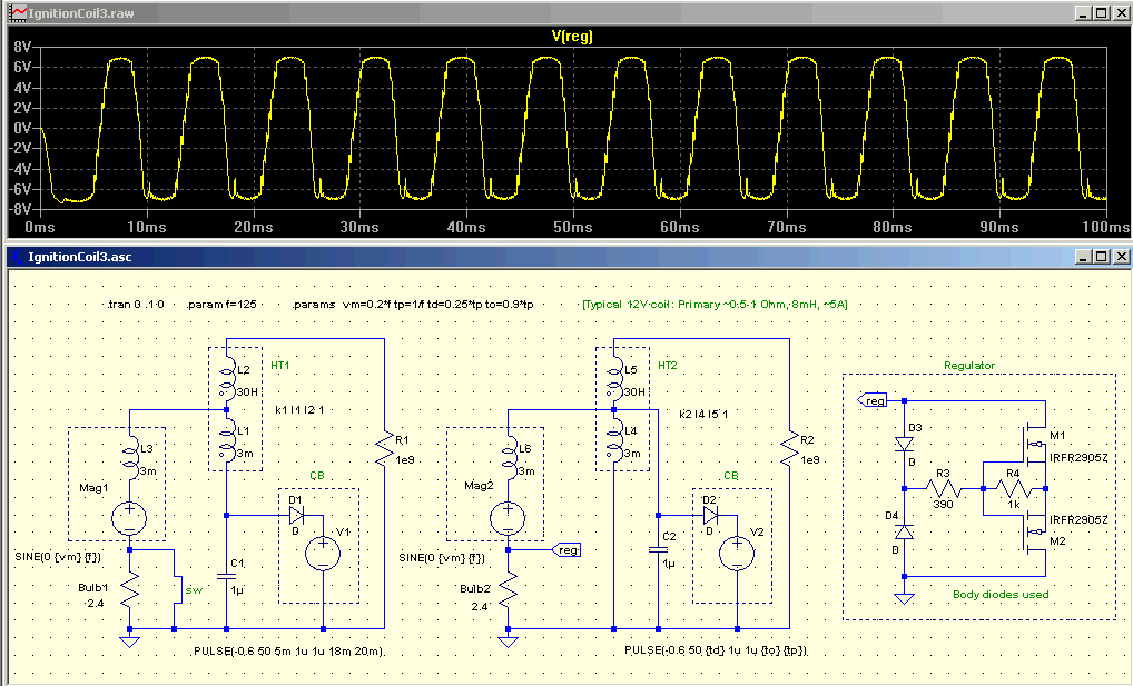

I've been having a play with simulations of (a) a conventional car-type Kettering ignition system with the points in series with the ignition coil primary and (b) the system as per the 98ss diagram. I was surprised to find that (b) gives a higher HT voltage (I think because there's a greater current change when the points short the magneto coil). So the MC manufacturers are right and I was wrong on that score ;).
I've also come up with a possible way of regulating the brake-light voltage, using a couple of FETs. The 'regulator' (shown in the sim circuit below) clamps the voltage when it tries to go above ~6V (adjustable by resistor selection) and simply connects across the brake bulb/switch.
Alec, your three diagrams are 1) the system as it is now, 2) system w a regulator, 3) regulator design. Am I right?
Not quite. The left part (1) is a Kettering system with the points in series with the primary of the HT ignition coil (transformer). The middle part (2) is the system you presently have in the 88ss diagram, with the points shorting out (i.e. in parallel with) the magneto coil. The right-most part (3) is indeed the regulator, and although it's shown separately it is an active part of the simulation by virtue of the connection marked 'reg'. The waveform shows the regulation effect at high revs.

What's you design equations for the regulator?
Diodes: any general purpose silicon, e.g. 1N4148, 1N400x, ...
Resistors: 1/4 Watt
FETs: as shown, or other automotive type, low Rds(on), each able to handle at least 15W for as long as the brake is 'on', package easily mountable to heatsink, must have body diode which can handle >5A.
Note: Without electrical isolation the FETs would need separate heatsinks and the heatsink(s) could not be bolted directly to the bike chassis.
alec:
Vout = f(r1,R2,R3) ; What's f. Theory of operation?
Do, you really want a 1n4148? The diode doesn;t carry the full current?
I thought it was something like in one direction, the diode conducts and flows through the voltage-divider like thing and then through the non-conducting MOSFET body diode? But I can;t quite figure out the design equations.
In the sim, f is the magneto frequency. For the particular instance shown I chose f=125Hz (corresponding to 7500rpm, modelling one cycle of magneto waveform per flywheel rev). Open circuit output voltage vm of Mag2 is modelled as proportional to f. Wave period tp is 1/f. Points-open phase delay td and open time to are fixed fractions of tp.
Consider a positive half-cycle where V(reg) is >0. Current flows via D3, R3, R4 and the body diode of M2 but is only about 4mA peak (essentially just to charge the gate capacitance of M1). M1 conducts if the gate voltage (set by divider R3,R4) exceeds its turn-on threshold (about 4V in this example) and so bypasses the D3,R3,R4 string. So the vast majority of the current is through M1 drain-source and the M2 body diode.
For a negative half-cycle, current flow is instead via D4,R3,R4,M2 and the body diode of M1.
Well, that's the theory :).
In practice we would hope the two FETs have fairly well-matched Vgs(threshold), so that they share the power dissipation evenly. If they are unmatched then each FET could have its own 'R3' to set the respective gate voltage appropriately. A bit of resistor tweaking will be needed so that the desired clamping voltage causes the divider to supply the thresold voltage to the gate.
Edit: Although a trimpot could be used to set up the divider when bench-testing a prototype, fixed resistors should be used if the regulator is bike-mounted, because a trimmer would be unreliable when subjected to vibration.
