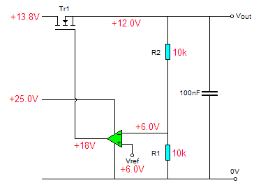

ultra-low-dropout-gif.9392
Use a P-Ch MOSFET instead and one would not need the many components of the 555 voltage doubler. Of course one has to swap also the two inputs of the opamp.
Of course, in fact this was adapted from a circuit using a p-channel MOSFET but p-channel MOSFETs have a higher on resistance, therefore it will have a higher drop-out voltage.

The 555 is a voltage doubler oscillator that powers the opamp with a supply voltage that is nearly double the supply. Because the gate voltage of an N-channel Mosfet needs to be up to 10V higher than its source voltage.
If you use a zener diode connected to the gate of an N-channel Mosfet, then its source (output) would be up to 10V lower.
I had seen this circuit posted before so thought i'd try it. It works very nicely indeed. Not certain of it's working though, the MOSFET can only be switched on or off? So how does it regulate? Is it as soon as the voltage goes over, it switches off, then the output drops back and it turns back on? So it effectively switches on and off quickly to keep the output within the limit? If that is true, presumably is doesn't waste power as heat so much either?

The N-channel Mosfet is a linear source-follower. It gets VERY hot.
A circuit can be designed for a hot P-channel Mosfet and won't need an oscillator to make a high voltage supply for the opamp, but it is tricky to stop it from oscillating because then the Mosfet would have voltage gain which adds to the opamp's voltage gain.
Yeah, but how i'm seeing the design is that the input to the MOSFET gate is either high (about 2x the supply voltage), or low (ground). And as such the MOSFET is either on or off? How is it that it functions linearly? I must be missing something.
It's called 'negative feedback', the FET isn't switched ON or OFF, it's being fed from an opamp, NOT a logic gate. Even though it's wired as a comparator the output will be an analogue voltage within it's required parameters - so if the output increases slightly, the output of the opamp will change to compensate for it. The capacitor across the output helps it all to stabilise, otherwise it would tend to switch.

Like I said, it's an opamp, NOT a logic chip - as it goes from -ve to +ve, it obviously has to pass through all the linear voltages possible in that range. So by VERY accurate adjustment of the input voltage you can get a linear voltage swing from the output, for a VERY small input voltage change.
Due to the massive gain of the opamp this input voltage change is too small to do manually, but the negative feedback does it automatically, continuously altering it to keep in the linear region. Pretty well any regulated PSU with feedback works in this way!.
The Mosfet is at the ouput of the opamp and is included in the opamp's negative feedback loop. So if the resistors have an equal value then the opamp-Mosfet amplifier has a voltage gain of 2. If the Ref voltage is 6.0V then the output will try to stay at 12V even if the output is nearly shorted.
I have the Mosfet shown with its gate-source bias at only 6V but it could be as low as 3V or as high as 10V.
No problem, add a 100k resistor in series with the MOSFET's gate, this act with the cate capacitance to form a low pass filter which will preven oscillation. I prefer the N-channel follower anyway because it has a lower dropout voltage.
