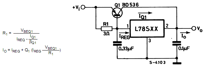

the better way is to use switch mode regulator at such high loads. if you want to continue with linear, the way is to use series pass transistors with one regulating element

with linear regulation with 8V differential across, it really smokes at 20 amps
parallel working is problematic as you cant equalize the load across the number of elements
Can I have 5 2A voltage regulators in parrallel to regulate 20V to 12V?
This is in general a bad idea as one regulator tends to take most of the load itself and therefore will burn first. Thereafter the other will probably burns one at a time.
If you had read through the datasheet, you would have found this method to boost output power:
