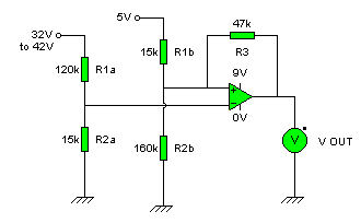

First use a potential divider to scale the input voltage to a range safe for the op-amp. I used a potential divider consisting of 120k and 15k.
I'm not going to say any more for now, other than I went through the tutorial and calculated the resistor values and simulated the circuit.
Have a go yourself and I'll give you a hand.
EDIT:
You won't be able to get exactly between 0V and 5V but you should be able to get pretty close. According to the simulation, I managed to get a voltage range of 74.1mV to 4.99V, using E24 values for all the resistors.

Oh well as it's not what you want I'll post my solution, for the benefit of others.
Then you need a 32V voltage reference (the TL431 can do that) and a differential amplfier with a gain of 0.5.

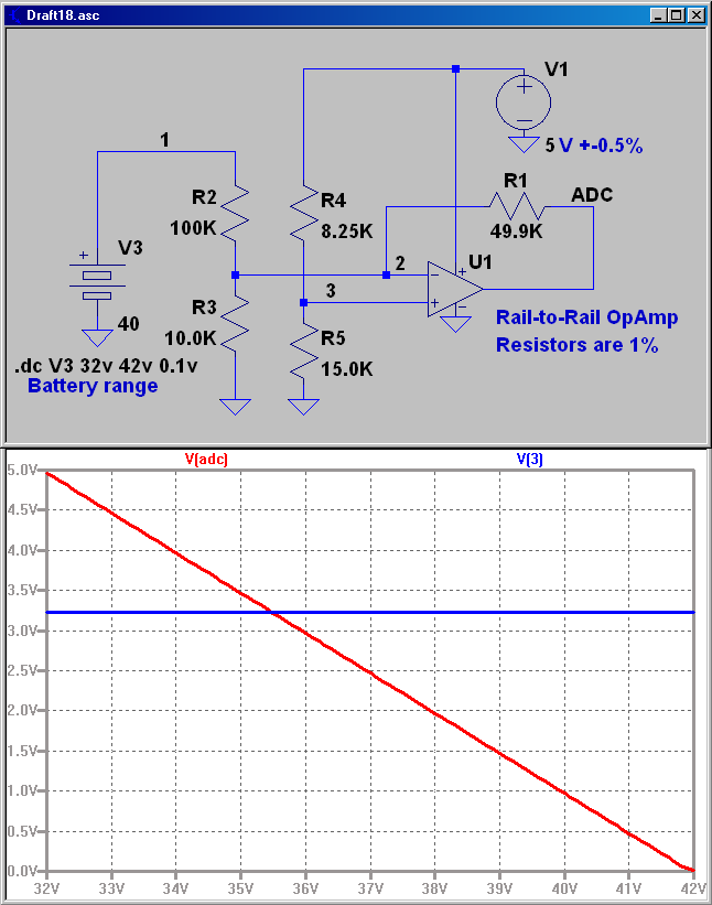

If you are willing to negate the ADC reading in software, then you can do it with a single Rail-to-Rail Opamp operated off the same 5V supply that is used as the reference for the ADC.

I already posted that circuit, you just used different resistor values and a rail to rail op-amp powered from 5V.

In that case use Mikes circuit post #9, if you need to invert the sense of the signal use a 2nd OPA as an inverter.
