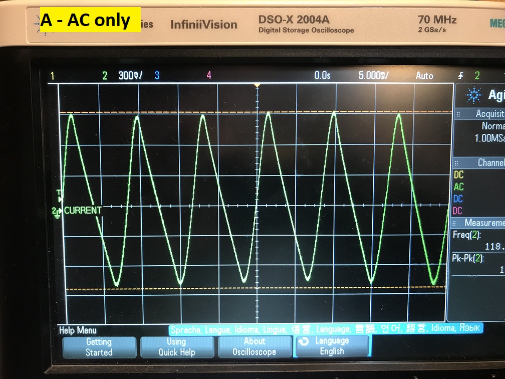

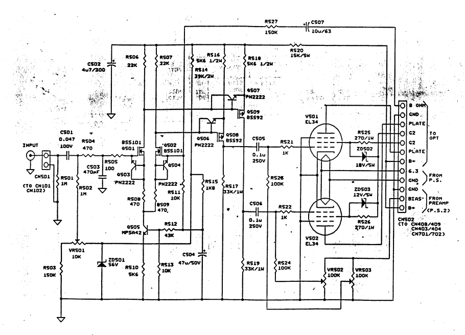

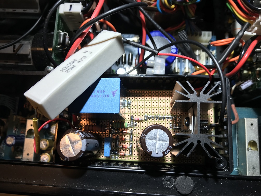

I am rebuilding an older modification of my audio tube amp (AMC CVT3030) which is broken.

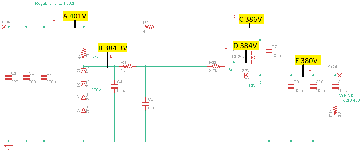

It's a source follower buffered Zener working as voltage regulator, mainly to supply the tube final stages of the amp.

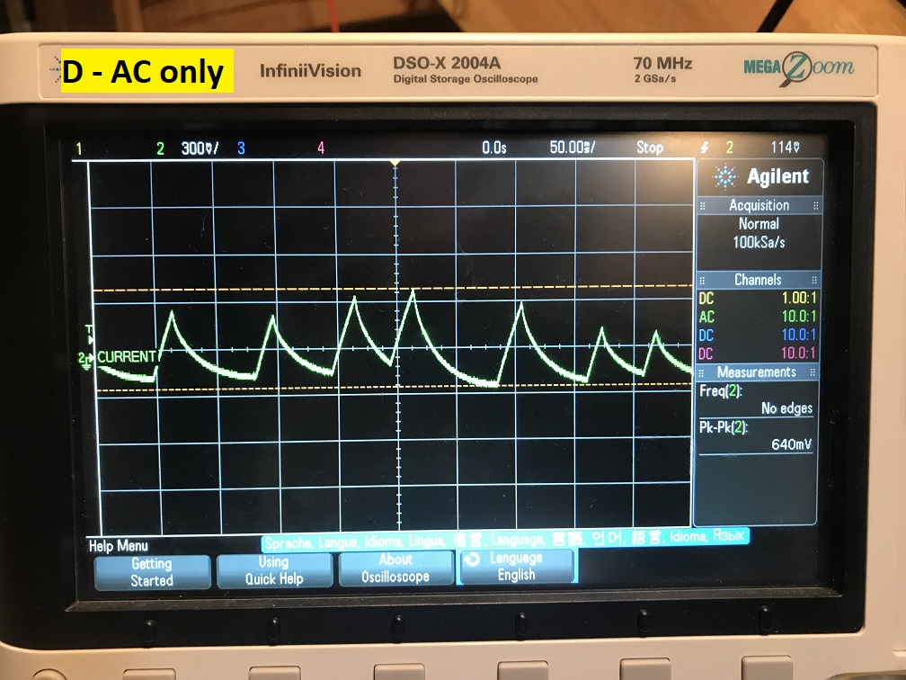

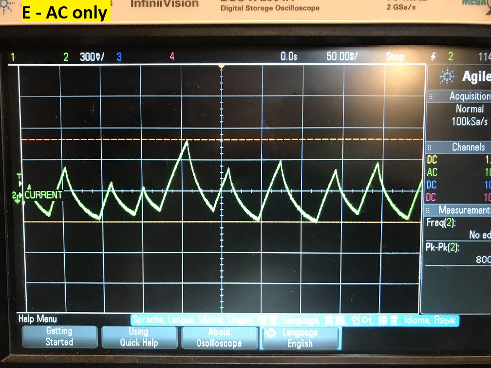

I am attaching the schematic with the DC values marked and pics from oscilloscope measurements.
As you can see, the output is not stable when I connect the circuit to the tube modules (B+, G2, Plate on the schematic also attached).
I noticed that when I turn on the amp the regulator works fine and once the tubes start drawing more current, the output voltage (E) starts to wander
This is also in line with another test I did, with a couple resistors as a load (8k and 15k) where the output voltage stays very flat and everything works just fine.
I tried also to bypass R3 and get a higher Vds so that the mosfet has more room to regulate.
However the result is the same.
Does anybody have an idea of what is going on?
Thanks a lot,
Fabrizio
