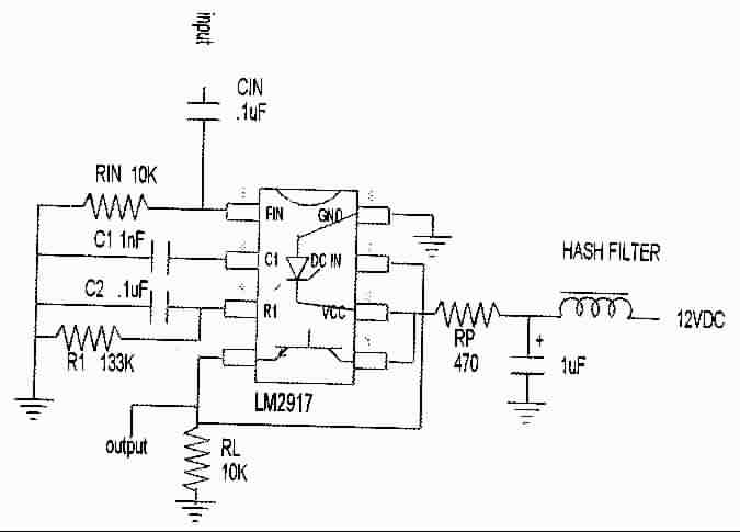

i need help trying to make a voltage to frequency converter out of just 741 opamps and npn tranisitors. i need to convert 1 volt to 1khz square or triangle wave.

Use the LM2917 circuit:
The hash filter is only needed in an automotive application.
Russlk said:
Get the National Semiconductor application note AN162, it shows how they make the frequency to voltage converter.
The title of this thread is 'Voltage to frequency converter', presumably a VCO (voltage controlled oscillator).
