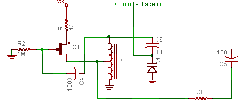

Voltage to Frequency Converter....
Create an oscillator and use a varactor diode as a tuning element. A Varactor is just a diode used while reverse biased, I think some transistor junctions can be used effectively (if not ideally) as varactors.
Use the voltage to control a current source. Use the current to charge a capacitor. Put the capacitor inside an oscillator.

The simplest example I can think of was hinted at by 1234...
Build a simple two-transistor astable multivibrator. Instead of connecting the timing (base) resistors to Vcc, connect them to the frequency control voltage.
Here is one I use quite often. It is a Hartley oscillator. You can replace the varactor diode with ordinary diodes such as a 1n914. You can increase the ratio of voltage to capacitance by paralleling diodes in place if D1.
