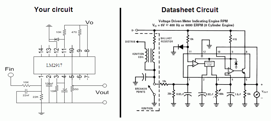

Hi there I have troubles with LM2907. My problem is that I have to do a voltage to frequency converter which is 466.67Hz = 3.5V where 3.5V represent 14000rpm.
Its for an R6 engine, please please help
I have tried the circuit of the data sheet and does not work. I also tried to insert the correct value of RC which is
V=finxVccxRxC
R=10K
C=0.1uf
RC=1ms
and Vcc=7.5

Are you certain that your car has good old breaker points that the circuit is designed for, and not the newfangled spinning magnet thingy? The datasheet shows a different IC for the variable-reluctance type of RPM sensor.
V0 in your circuit should be about 13V, and pin 9 is regulated with a zener diode to about 7.5V. Is pin 9 your 7.5V Vcc?
Did you use a voltmeter to measure the output, not the dead short of a current meter?
The circuit in the datasheet has different capacitor and resistor values. Are these the ones you tried?

My engine is an R6 engine with the following specifications:
RPM(max)=14000
number of cylinders=4
But I am getting a feedback from the ECU which is 2 pulses per revolution since is a four cylinder. Therefore
14000 at 60seconds
x at 1seconds
x=233Hz
output=233x2=466Hz
A more accurate output is of 466,67Hz
My Vo is 7.5 Volts
I also use the voltometer to measure the output voltage :)
My circuit is using the capacitor values that I have in the diagram i designed to produce the following characteristics
V0=7.5 V @ 466.67Hz or 14000 ERPM (4 Cylinder Engine)
Vout=3.5V
Hi Magos,
1) In your 1st post you used an LM2907. But your schematic shows an LM2917. What do you have?
2) Most circuits in the datasheet use a 9V-16V car battery and the 470 ohm resistor you are using drops it for the zener diode regulator in the LM2917. You say that your Vo supply is only 7.5V but the IC's current through your 470 ohm resistor drops the 7.5V to about 6V for Vcc (pin 9). This 6V isn't regulated nor decoupled and is probably swinging all over the place. If you really do have only a 7.5V supply voltage (where from?) then your 470 ohm resistor should be replaced with wire only if you are not using an LM2917 with its zener diode.
3) Most circuits in the datasheet use a 20nF cap at pin 2 but yours has 100nF. I think that 100nF can't charge and discharge properly with input frequencies above about 200Hz. Your frequency is much higher, requiring a cap with a lower value.
4) Most circuits in the datasheet use a 100K resistor at pin 3 but yours has 10K. If you use a 100K variable resistor you should get a 3,5V output with it near half, when the cap at pin 2 is 22nF, and the 470 ohm resistor is shorted out.
5) What is the voltage of the circuit's input pulses from your car's ECU?

1) You are right my post way for the LM2907 but finally I used the LM2917.
2)I am using a 7.5V source for testing which will be changed initially with a regulator which will change 12V to 7.5V. I will use a wire instead for connecting pin 9 your idea seems very reasonable.
3)So you think using a 20nf capacitor and 100K resistor and finally short pin 9
The supply voltage for the ECU is 12Vots and before feed in a relay is used, don’t know if this answers your question
Hi Magos,
By using a 7.5V supply with an LM2917 you risk blowing its zener diode.
Why not use the 470 ohm resistor on its pin 9 and use a 12V supply like it is supposed to be? Then the zener will regulate its Vcc at 7.5V.
It will work fine when built like in the datasheet, but you don't know the voltage level of its input pulses from the ECU.
Hi Magos,
Your circuit's input from the ECU is perfect. With the couple of changes I recommended, it should work fine.
