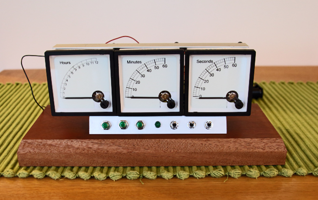

I am adding a "Voltmeter Clock" clock to my Master clock system.
I have used a design by Alan Parekh and have modified it to run 3 voltmeters sourced from Ebay.
Alan's site is here **broken link removed**
I am going to try to modify the code so I can synchronise it with my DCF77 synchronised Master Clock.
The basic clock (see pic of experimental layout) with modified meters is up and running using Alan's code. I have mounted it on a temp piece of wood for now. The meter dials were drawn up using Turbo cad, the old dials numerals sanded back resprayed white then the new dials transfered on using inkjet transfer parer.
On the finished clock I want to mount the control switches into the base under a perspex flap leaving the dials suspended on metal pillars. The perspex flap will illuminate with the seconds beat. All wiring PCBs and hardware is to be left exposed under a clear perspex cover.
I may also add a small relay to give the clock a tick.

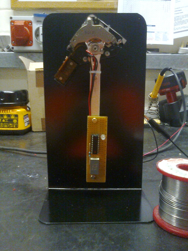

Another one thats on my bench here at work:
Its a pendulum clock, the display is a single 7 seg that swings as the weight, and the 'drive' is a hard drive voice coil read head assy jigsawed from a scrap hdd.
Causes plenty of interest.
This one is simple so could be a candidate for a dcf77 mod, theres plenty of room/power in the pic16f88 for it.

Nifty idea about connecting power to the display board, I used the allready existing flexible pcb that goes to the read head, its been swinging for months now with no problems, the clock keeps its own time via a 32kc xtal and the pic's timer1, and is surprisingly accurate for something untrimmed about 2 or 3 secs a week.

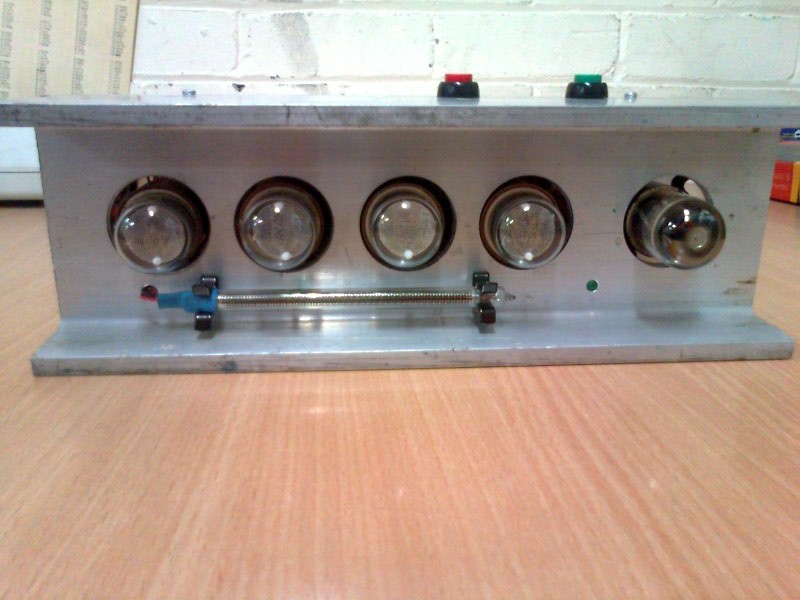

Heres a nixie I built into a girder (yes I know), seconds is done by a bargraph, this one tells you the date (via msf) and temp/humidity too, theres also a dekatron pendulum on the far right.

I have finished my Voltmeter clock at last. I had to convert Alan's code to the new version of Picbasic Pro and then add a bit of code to sync it to my master clock. It now keeps perfect time.
Here's a pic
g9QZ4m
https://flic.kr/p/g9QZ4m
and an animation showing sync on 30 sec master clock pulse
and normal running
