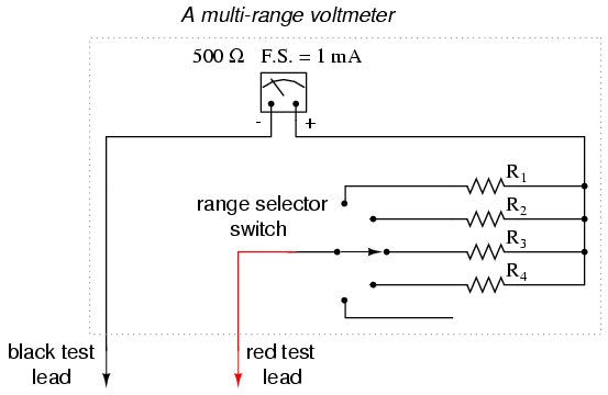

Thank you for repling. I am doing an HNC college course, and the project that I have been set is to design (on paper - no building required) a multimeter for the blind. I know the idea of a blind man, or woman, using a multimeter is ridiculous and quite unsafe, but that is what I've been set.
Thank you

I like the idea of voltage to speech conversion, or possibly a braille display. Have you seen any circuits for such a thing. How would you go about making the speech system recognising what its input is and giving an output?
I have learnt a lot form this site http://www.faqs.org/docs/electric/DC/DC_8.html Would I be able to use the circuit shown below and connect it to a speech system.
Any clever ideas for making an output which a blind person could interpret would be most appreciated.
Thank you

How about a large face analog meter movement with a window through which the user can feel the pointer position and braille numbers on the scale? Gently pressing the pointer down against the meter face could be fairly safe for the movement with a little practice. You would have to provide some type of dust cover to keep the movement clean.

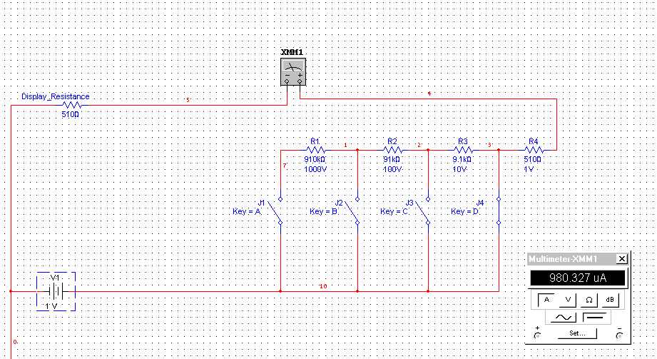

I have found an IC which could convert a binary input into speech (by assigning each spoken number to a different address)https://www.electro-tech-online.com/custompdfs/2006/05/33193.pdf , but I need to convert the analogue reading into a binary number. My design currently works with a 1mA full scale deflection.
Please would you help me interface the analogue signal into speech.

u'll need an adc to convert the voltage to binary . i would prefer a micro with built in adc for the job , so that it can convert the read voltage values to bcd and generate address signals to the speech ic .
attach the image a gif image , it would be a lot smaller .
