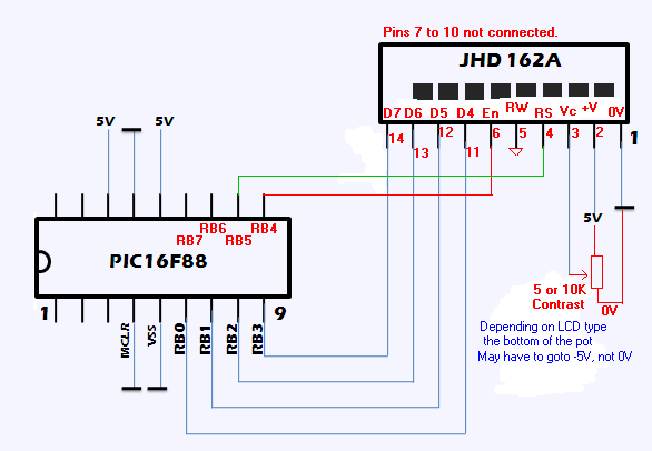

I was building a simple wattmeter using the schematic as shown here
And the ASM code for PIC16F88 here to drive the JHD162A LCD as well.
(The code is on 4 bits HD44780, but is compatible with KS0066 driver used here.)
However after I'd built the circuit, I found that LCD shows nothing.
And I wonder if I had done something wrong on my code or what, or maybe thay said I need some kind of driver "wake-up" for the LCD module?
Thanks if you can help.

Looked thru the source code.
There is no point in working on a complete program if one part of the hardware is not working.
Look at this short LCD diagnostic code.
It was derived within Oshonsoft and it does work in simulation, I dont have a 16F88 on the shelf.
In the code are the PORTB pin assignments for the LCD, almost the same as yours.
As you are working on a project board it should be a simple matter to re configure the LCD pins on your project board,
DONT change the program to suit your existing wiring.
If the LCD does not work with this simple program I would suggest trying a new LCD.
Lets know what you find.:)
BTW: what are you setting the INTOSC freq too.?

Connection as shown below:
All I can see is ....
Yes there is a contrast on the block and yet i see it blinking periodically...
somehow there is alphabet inside but overall just blinking black square ...
How about R/W, RS and E line?
RB0 have to go to lcd pin 11
rb1 to 12
and so on
rb1 to 12
and so on

I'd connected LCD RS to RB5, LCD RW to ground and LCD E to RB4 as mentioned here:

hi tt
Your dwg wiring is not the same as my code.!
Also did you see my edit ref the OSCCON line,
; 19:  'portb,0 = D0
; 20:  'portb,1 = D1
; 21:  'portb,2 = D2
; 22:  'portb,3 = D3
Where and how is the Contrast pot connected to the LCD.?

OK..so I might connect it wrongly here .... Mind to give me advice?
OSCCON line? You mean the one posted as lcd88c.asm?
The contrast pot i can see (with backlight ON) is juz the second line with black square ....
the connection of the pot is as shown at the schematic above.

Its the lcd88c.asm .:)
If the pot is connected as shown, how will it change the contrast.?
I'll post a dwg.

Edited your dwg also attached lcd88d.asm
OK.?:)

By the way if the contrast pot functioned like the one i mentioned.... so does it mean it is not necessary to connect to -5V, right?
Hi ttbuddy,
Could you check LM2936-3.3 output is 3.3V, I thought the Ic connect wrong way,also seem RB4 not connect to E LCD pin
