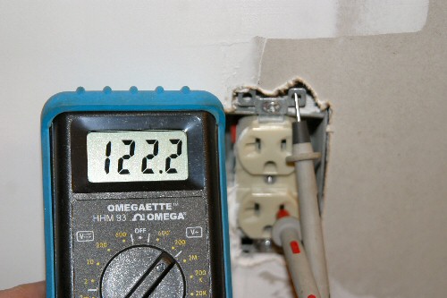

In one of my bedrooms, the plugs read 70-75 volts from Hot to Ground. They measure 122-125 from Hot to Neutral.
That is weird.....isn't it.?
Neutral and Ground are at the same potential are they not.?
Thank You

Are you measuring this voltage using a DVM? Due to the high impedance of these devices then simple coupling could give you an erroneous measurement from neutral to earth. It's all about knowing your measuring equipment and how it works as it is about what you are measuring.

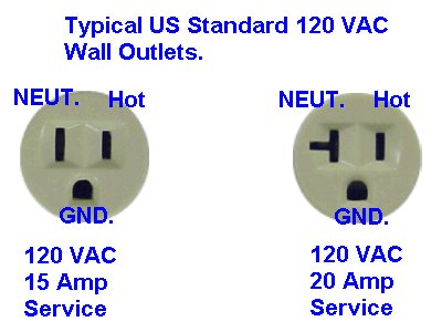

The standard outlet (120 VAC 60 Hz) wiring in today's US homes should have the neutral and ground connected together at the service entry point. Older homes did not use a third wire ground. Assuming a newer home with correctly grounded outlets you should read line voltage between line hot and neutral and also line hot and ground.
Many older homes in the US still use what was known as Knob and Tube wiring which does not provide for or include a third wire ground. You need to know how your system is wired.
If we assume your home wiring to be newer and correctly installed my guess is a broken or poor ground connection. If you are comfortable checking it yourself I would go to the mains entry and shut off the power to the outlet(s) (circuit breaker or if old fuse) and only once power is removed then remove the outlet and inspect the connections to it. If this symptom shows up on several outlets each branch should tie together at an access point where all the grounds are joined. Somewhere something is likely loose.
This was one of the first lectures we had on an a Diploma in Electronic Engineering course.
He's measuring from hot to neutral and hot to earth, not neutral to earth. For his measurements the DVM should give the correct reading, which should be essentially the same for both conditions if the wiring is correct.
Yeah.......
Anyway, this is a "modern" home, 1988.
Problem occurs in just the master bedroom.
Only reason I checked was because I got a new DMM (Extech EX210) and just wanted to check it. Other rooms in the house measure as they should.
As you guys have suggested, I will have to pull the plugs and find out what is going on.
Probably take a few days, will let you know what I find......or if I need more advice.
Thank You
Use your DMM. Put one lead on 'hot' and hold the other in your hand. (touch the lead end with your hand). The meter will read.
I am just trying to show the meter will read 50 to 100 volts when connected to your hand not ground or neutral.
