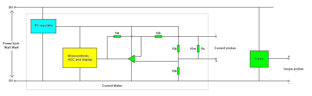

I have three projects that operate off of 9V I should be able to use one 9V wall wart to power them all if I hook them up in parallel right?
That depends upon the current rating of the Wart and the total maximum current drawn by the 3 modules.:)
allright Ill give it a look but voltage stays the same in parallel and current stays in series correct
Its Ok to say, the voltage stays the same in parallel providing the Wart can deliver the total current, if the Wart is unable to supply the combined current drawn by the 3 circuits, the voltage will drop.
Its not possible to give a meaningful answer about the current in series question until I know the circuits.
Do any of these three projects connect together?
For example do you have a distorter, pre-amplifier and power amplifier? If so there's a potential risk of a ground loop.

I am not talking about separate power supplies.
You are not looking at the bigger picture.
How do you know all the probes will be referenced to 0V?
This isn't a signal genrator or 'scope which will definitely have an input/ output referenced to 0V. It's a current meter which can measure both positive and DC currents so will probably have its probes biased at some other vcoltage to obserb the common mode rating of the input amplfier.
I doubt the current probes will be and even if they are it's potentially dangerous trying to measure current on the same circuit as the 'scope's ground is connected to. Suppose one of the probes is 0V (in which case it'd need a negative rail)? Measuring the current through the positive rail would short circuit the supply.
For example, suppose the current meter's amplifier stage looks like the one shown below.
What happens if the current probes are connected to 0V?
It won't work!
Even worse, what happens if the current probes are connected to 9V?
The op-amp is destroyed!
If the circuit being measured is not connected the same ground as the current meter, it doesn't matter because the meter's power supply will float at whatever voltage is required but as soon as you connect the 0V to 0V of the circuit you're measuring bad things can happen.
The problem is, we don't know what the current amplfier looks like so we can't say whether it's safe or not to measure current on the same circuit as the 'scope's ground is connected to. Of course, if it uses something like a hall effect sensor, then it won't be a problem but we haven't seen the schematic so we don't know.
