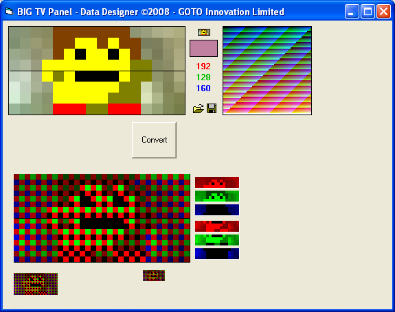

today i have been mostly building... a dataconverter/drawing package for the module when it arrives, just now it is set to 12bit colour (4096 colours). you can draw on the picture, load, save etc and you can preview as it will appear on the module (remember you need to be atleast 14 meters away from the module for best results - same here! lols) there are a few preview sizes to make life easier, aswell as RGB previews for top and bottom channels.
By tomorrow morning I should have the output data too, but I have to go out in a bit and dont want to start then leave halfway through.:)
