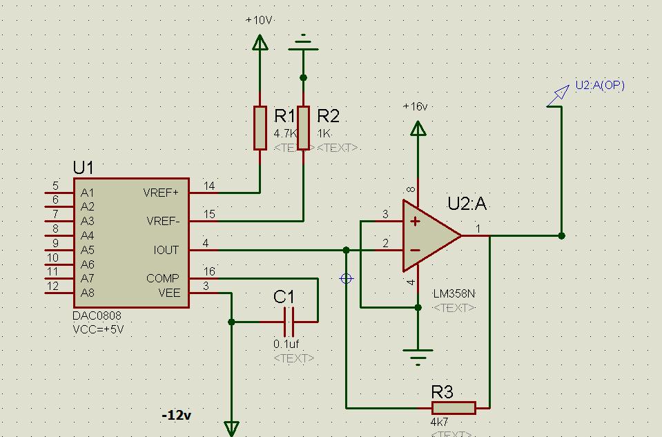

want to raise current up
kemo0o
Hey
i have built dac Simple circuit by 0808 IC
when i enable all inputs it gives me the refrence voltage (( that's OK)) :D
the problem is the current
is there any way to raise the current ??? to reach 1 A or higher
the schematic is attached

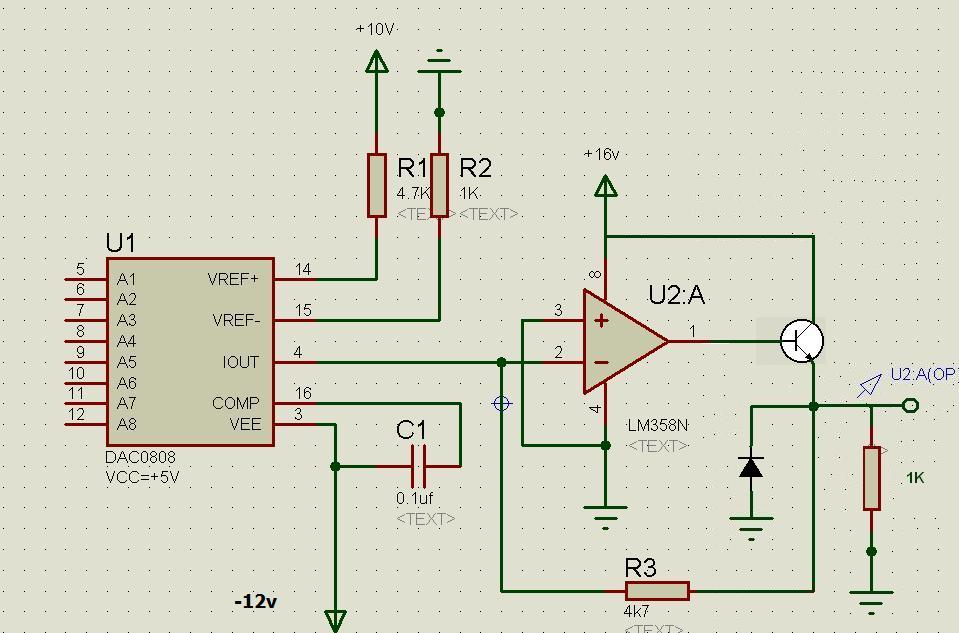

Well, you've converted the current from the DAC to a voltage with an op-amp and resistor. Do you want a voltage source output or a current source type output? ie: what do you need 1A for? It could be as simple as this, if you don't need high frequency response:
EDIT: Added diode for inductive load:

Hi kchriste,
no pity with the poor transistor? Give it a base resistor too. :D
Boncuk
It doesn't need one. As an emitter follower, it'll only take the current that it needs. Besides, the LM358s output is current limited to around 20-30ma anyway. kemo0o will need to use a darlington if he wants 1A output.
thanks for your reply it is very nice solution but what about your opinion that if i don't want high frequency
What are going to use the circuit for? Anything from DC to a few hundred Hz should be fine. I depends on the amount capacitance on the output and how fast you want it to respond especially when trying to lower the output level. This is because the output, while it can source plenty of current via the transistor, cannot sink much via the 1k resistor.

so what about it ?? is it fine or No ? << :confused: >> because i want to apply it about one or two days to use it
It will work OK. Since a motor is an inductive load, I've added a diode to the original diagram posted above. Your original PWM method is better and generates less waste heat.
