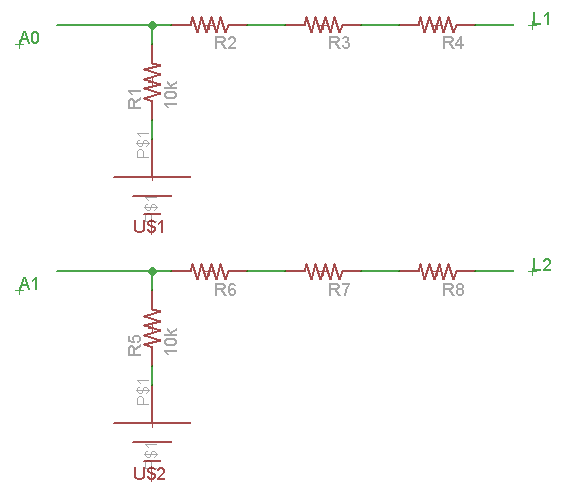

This is what I did recently. I did not want to connect the micro to "ground" or "neutral" because line and neutral get mixed up too often.
A0 and A1 are analog input on the micro.
L1 and L2 are two wires from the power company. (110,0) or (0,110) or (220,0) or (110,-110) Often neutral is more like 10 volts.
The power line voltage is A0-A1. Use software to subtract to get the voltage from line to line or line to neutral.
Use the resistors to divide down to the range the micro can read. (0 to 5V)
I used three resistors R2,3,4 because many resistors are only rated for 100 volts each.
The ground symbol is ground for the micro.

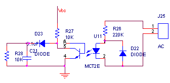

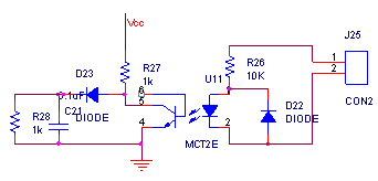

In this case there is no electrical isolation between the input AC and microcontroller circuit. So I am thinking of using an optocoupler to give this isolation. I am thinking of trying a circuit as shown below (values may be changed). Any suggestion?

In my circuit there is 300k ohms of "isolation". You are not really on the power line.
Optocouplers are not linear or temperature stable.

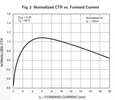

Here is a graph of CTR (some thing like gain) of a part.
A gain of "1" at 3.5 and 10mA.
Gain of 1.1 at 6mA
Gain of .65 at 20mA and 1mA
You can see the gain is very non linear below 2mA.
Use the part from 4 to 9mA.

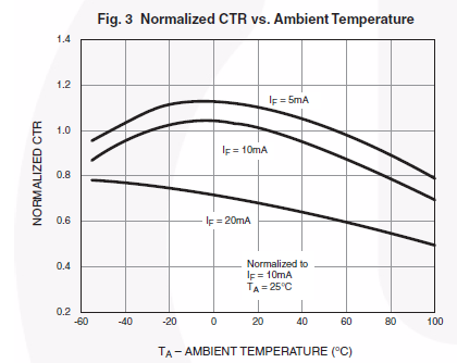

Here is the CTR verses temperature.
At 10mA the gain changes 6% from 0C to 25C.
Spice does not model this very well. You will have to try this.
Gain of 1.1 at 6mA
