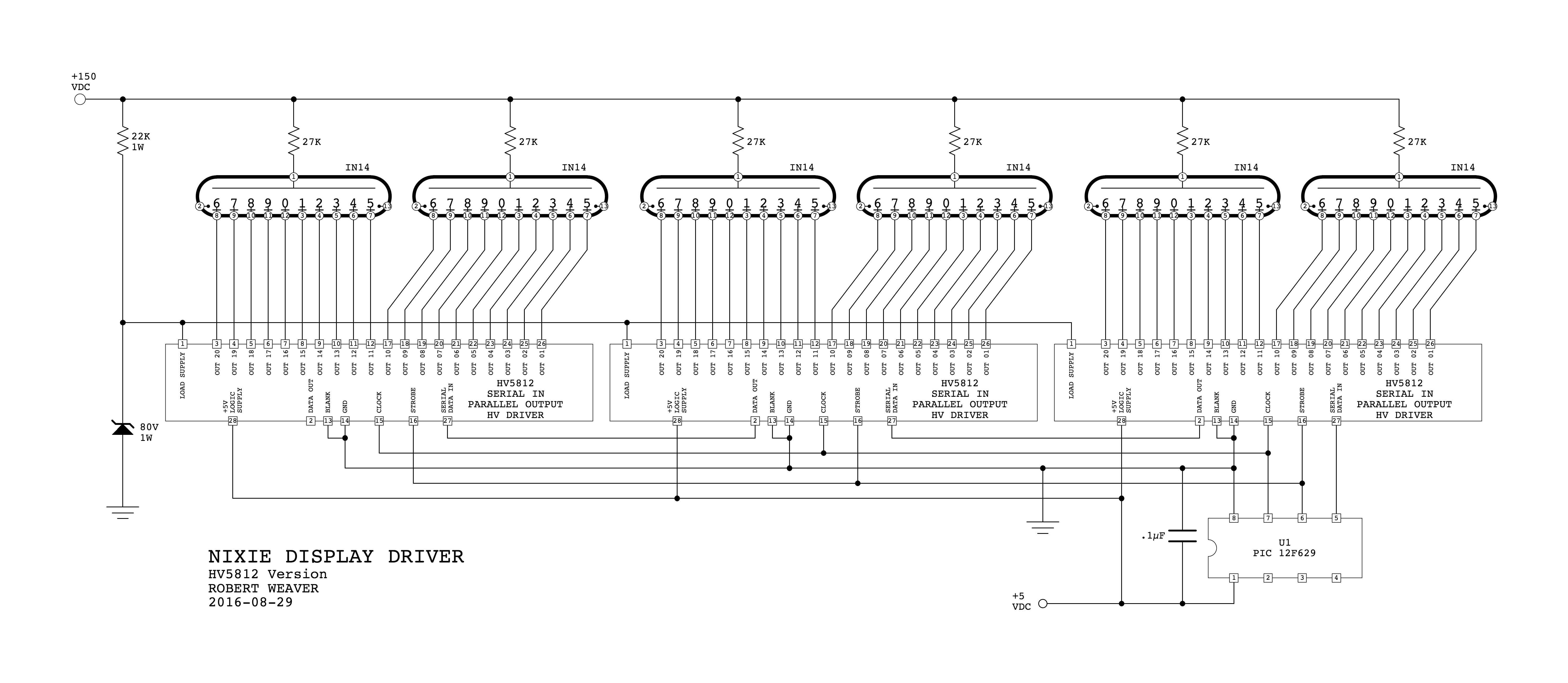

I don't see multiplexing as an issue. Yes there is a finite time for the gas to ionize, but there is also a finite time for the gas to deionize. Neon lamps are powered from 50/60 Hz all the time and they don't complain. And in that situation the polarity is alternating. However, you can also power them from halfwave rectified AC without any problem. For multiplexing Nixies, I'd want to keep the multiplex frequency reasonably high in order to prevent flicker. However, if I were starting from scratch, I'd use a PIC for the processor and one of the HV serial shift registers that I mentioned earlier so that no multiplexing would be necessary.
In a previous Nixie project, I used an Allegro A6818 high voltage shift register (now obsolete unfortunately) which has 32 outputs. So, one chip was enough to drive a complete 3 1/2 digit display. Plus, they could be daisy chained for 3 more digits per chip. Hence only two PIC output lines required for any number of digits.
Edit: see attached thumbnail for typical implementation of a PIC driving HV shift register drivers.

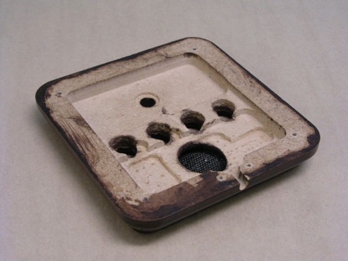

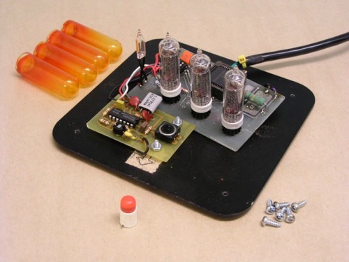

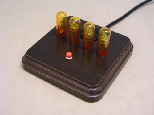

I was thinking something steampunk perhaps, or else an industrial look, perhaps something that looked like a vintage calculator of the period.
This is what my last Nixie project looked like. 20mm thick MDF with dark brown stain to make it look sort of like bakelite.
Would have looked better if I'd remembered to wipe the dust off before I took the picture.
The base was hollowed out to fit the electronics.
This is the 3 1/2 digit display using the A6818 driver that I mentioned previously.
