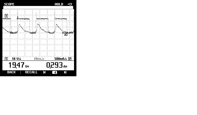

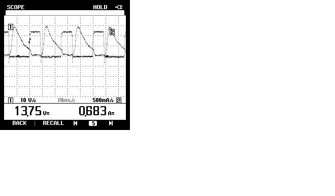

I had built a boost converter with a constant 24V output voltage from an input voltage ranging from 6-23V with a power rating of 100W. The converter is operating at 20kHz. I am able to boost up the voltage until 24V. But the problem is that my converter's efficiency is quite low (around 60-70%) and I am suspecting the losses in switch. I am using IRF540N power MOSFET.
Weird thing happen when I measure the voltage across and current through IRF540N. The current and the voltage waveform are in phase!!which means that when my switch is off, current passes through. when my switch is on, no current flow. But my converter is still performing well as it is able to step up my input voltage to 24V output voltage.
Any ideas??Please help me...My target is about 90% efficiency..
The 1st attachment is my diode waveform. The 2nd attachment is my switch waveform.
p/s: sorry for my poor english and can i post figure without using attachment? fluke2..jpgfluke1..jpg

The switch in a boost circuit does not conduct the output current, and is 180 degrees out of phase with it. Is that what you are seeing in your scope plots above?

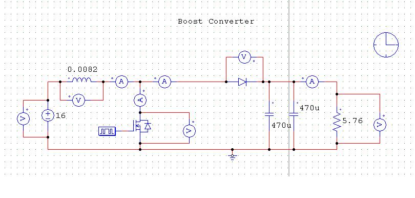

Where's the feedback?
With no feedback, the output voltage will depend on the load and could rise to a dangerous level causing the output capacitor and diode to blow if the load is disconnected.

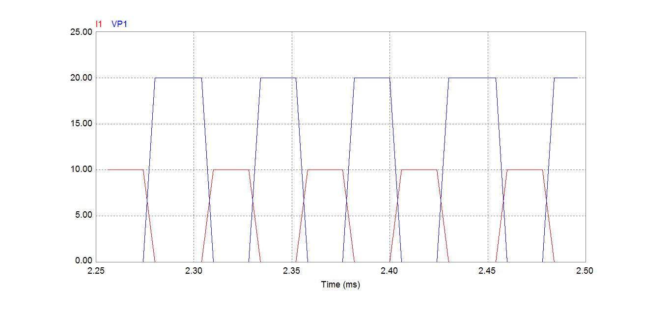

The current and voltage waveform should be out of phase. So, the losses will be V x I and it should be small.
To Hero999: I am sorry because I used the simple schematic here. Actually I had a feedback for the system. I knew the consequence if I didn't put the feedback. Thank you.

Back to my Question. Is it possible that a MOSFET in boost converter to have such a current and voltage waveform?? And is it cause by the inductor value (size), input current, MOSFET, MOSFET driver??fluke1..jpg

And yes, the current waveform through the MOSFET should be out of phase with the voltage across it, but make sure you have all the test equipment hooked up right.
