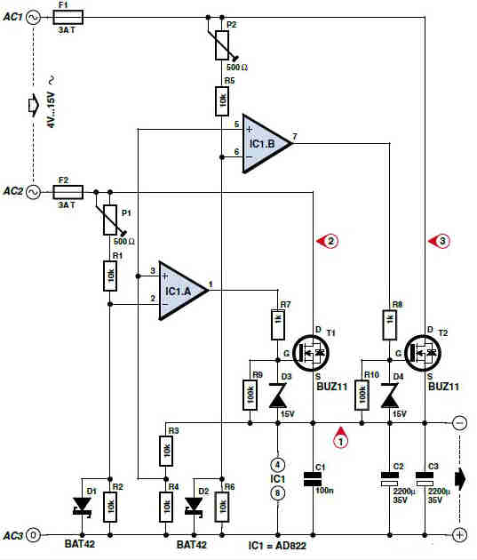

So - I've been trying to find info on using FETs instead of diodes in a full-wave bridge for a welder. I want to turn my old AC welder into a capable DC unit and a power source for a TIG add-on.
Why FETs? Because big (>100A) diodes get very expensive and I suspected that I could get plenty of MOSFETs to parallel-up for current at a better price (surplus) than suitable diodes.

It's pretty much what I was looking for. The use of P and N type FETs to use instead of diodes was what I was looking for.
I suppose (because I don't know) that I could parallel the FETs as well to increase the current capacity?

Hi bill-gj,
I don't recommend a full wave rectifier for a welder. A full wave rectifier requires both N-channel and P-channel MosFet transistors. P-channel transistors generally have a much higher RDSON than N-channel types which restricts current flow. Also the correct timing is crititcal with a full bridge rectifier. Resistors slowly age and out of tolerance an N-channel and a P-channel transistor might conduct simultaneously which means a dead short.
I made a two-way rectifier circuit using two N-channel transistors and an operatiol amplifier. It works pretty well.
You can have a schematic and a PCB layout via email, if you want.

Hello Boncuk, yes, please, I'd like to see the circuit if that's OK.
The prospect of just using N-types is interesting as, unless I am mistaken, they're more commonly available and cheaper than P-types (?)
Hi bill_gj,
here is the schematic of the circuit. This example can deliver 5A at 15V (transformer output voltage 12V) without heat sinks on the transistors. The transformer used must have a center tap (AC2).
Using a solenoid transformer and two IRFZ48N you can go as high as 27V output voltage (with load connected) at 10A. In that case the transistors require a small heat sink. (The max voltage is the supply voltage restriction for safe operation of the OpAmp, (32V))
Using a TLC272 instead of the AD822 OpAmp use the original TI-manufactured IC. It is the only one which switches to zero, which is a must for the circuit function.
Measuring points 1, 2 and 3 are given for best adjustment. Adjust 50 - 100mV (no DMM! Oscilloscope only!) between 1 and 2, respecetively 1 and 3 with pots P1 and P2.
The circuit uses the parasitic diodes in the transistors to gain the supply voltage for the OpAmp, which is already present after the first AC cycle.
And yes, N-channel MosFets are more widespread than P-channel types, hence they are to be cheaper.
If you PM me your email address I'll send the Eagle files, including schematic, PCB-layout (single sided) and BOM. I'll translate the circuit description from German to English for you, too.
