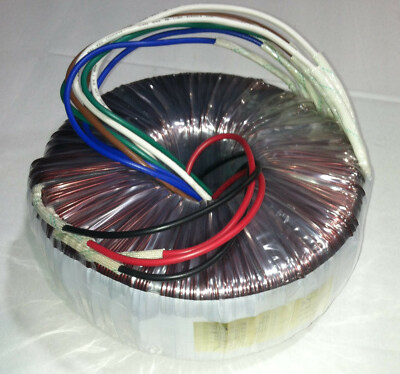

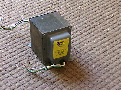

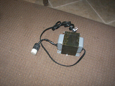

First, an isolating transformer.
Examples; there are many available in different power ratings:
A 500VA would provide up to near 2A at 250V output.
A 1500VA near 6A.
The transformer needs fusing before and after, and following by an appropriate high current & high voltage bridge rectifier, smoothing capacitors and a current limiting device of some sort, appropriate to the current the transformer can safely supply. That could be as simple as a suitably rated filament lamp.
The second transformer above can also be configured to provide 230V out for 115V in, so a normal bridge rectifier rather than a voltage doubler.
