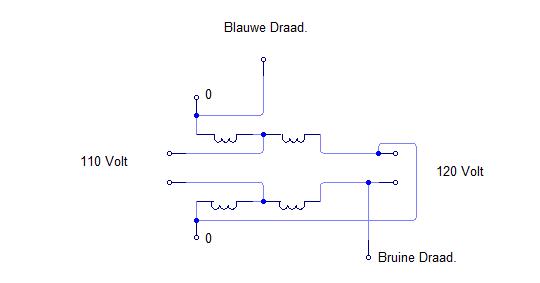

I have a question about a current limitation in a power supply for a Tube preamplifier output 215 Volt.
The question is Does this work if you accidentally create a short circuit?.
Here is the diagram of 2 different power supplies, the first one broke due to a measurement error, of which it is not entirely clear what went wrong.
The second diagram is of a tube preamplifier from Audio and Technology from a long time ago, I personally think the current limitation of Audio and Technology looks better.
When I simulate in Tina Software, the current limitations of both seem to work, but as I wrote before, the power supply board of the first diagram broke after a short circuit.
What is the opinion of this Forum about the two power supply diagrams?.

Dear Forum Members,I came across this Shunt regulator, and am curious about the reactions to this regulator.
What would this do on a Tube preamplifier.
In Tina Software it seems that this regulator is short-circuit fixed, but that is still the question.
The question remains is this a stable circuit?.
