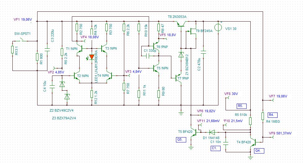

Dear Forum Members,
I have a question about a current limitation in a power supply for a Tube preamplifier output 215 Volt.
The question is Does this work if you accidentally create a short circuit?.
Here is the diagram of 2 different power supplies, the first one broke due to a measurement error, of which it is not entirely clear what went wrong.
The second diagram is of a tube preamplifier from Audio and Technology from a long time ago, I personally think the current limitation of Audio and Technology looks better.
When I simulate in Tina Software, the current limitations of both seem to work, but as I wrote before, the power supply board of the first diagram broke after a short circuit.
What is the opinion of this Forum about the two power supply diagrams?.

Sound is a matter of taste, and tube sound is sometimes a pleasant change.It is a matter of switching cables and my other transistor preamp is playing again.Tomorrow I want to try the electronic fuse on the 19 volt power supply, can that be done with the same resistor values R5 510K and R4 1 Meg?.

I had changed something else to not put the Q5 collector on the base of the output transistor.

did you have time to look at my last picture where the Q5 connection is connected via a 1k resistor.
No, but I just did.
Q5 should go to the base of T8 with no resistor.
Why did you add the resistor?

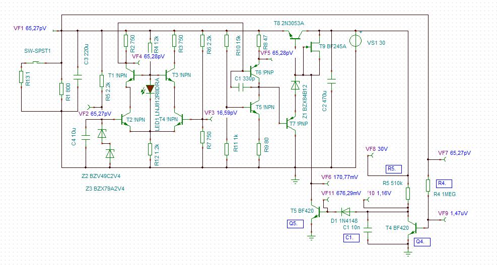

I was looking at your circuit that you set up in LTSpice-sim, but I don't think it will work in the last 19 volt supply, because Q3 is not included in it.
Yes, your last circuit has no current limit.

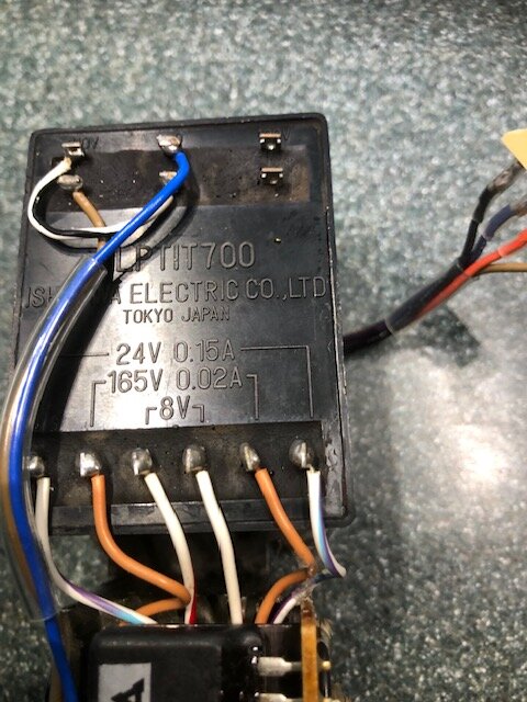

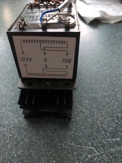

That's because it's a power supply for a preamplifier, which normally only needs to supply 100 mA.But I found a unit for a Nixie cash register in an electronics store, where a lot of dump material is sold, it was only € 9.00, I couldn't leave it there.This can supply 165 volts at 110 volts, there is also a 120 volt winding at 20 mA, that's enough to test on the 215 power supply.But the question is can a 230 volt primary be made from these separated windings?
