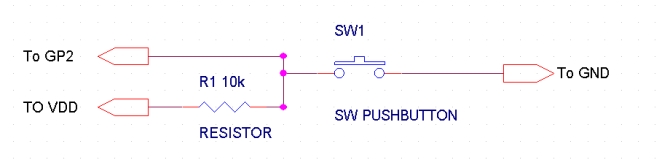

to simplify things can you post a schematic?
You said "There is no residual power on GP2, as there is a10k resistor to GND."
try the 10k to vdd and when switch is pressed it ties to ground.
if you dont want to change circuit try "btfsc"
