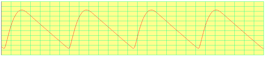

New information:
The output from the wind turbine is a 'sortof sinewave'
It was measured with an occiliscope, and it definately has the sinewave shape, but it does change.
It starts off at around 30 volts +- 15volts at 2 hertz, and climbed to 90 volts +-22 volts at 4 hertz during the measurement period.
That makes sense, does the ripple look something like this?
YES!
That is almost exactly the wave being generated, However, you appear to have a constant voltage in your example, whils mine does drift up and down due to the wave being driven by windspeed and the wind is not always constant. But yes, that is what the DC looks like when we plugged the Occiliscope into the +ve wire.
Does this have any meaning?
I just simulated a three phase voltage source driving s three phase bridge rectifier and ploted the DC-side waveform.
There is no special name, it's just called ripple.
Connecting a huge 200V 1000µF capacitor will reduce the ripple dramatically.
