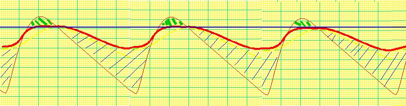

Am I correct in thinking that charging the capacitor uses up some of the voltage?
So that if we have your saw-toothed graph, the peaks are chopped off ( ie the Green areas) as the power is used to load the capacitor, and then the valleys are filled by the capacitor unloading power? - So there is no voltage above the Blue line, as this is used up loading the capacitor?

The optimum voltage is probably more like 13.8V.

I now calculate the maximum voltage I could have put into those batteries is 69 volts, being 13.8 x 5.
When I rebuild the bank, I will set the charge limiter at around 69 volts.
The batteries are in series therefore the current through them is the same.
Before you connect it, I suggest you check that all the batteries are good and there aren't any shorted cells which could result in destruction of the other batteries.
69V is a good voltage to limit it, 75V is probably safe but 69V is safer still.
