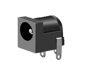

To anhnha: if you are building that circuit, I would recommend using a DC-plug/connector/jack (whatever the official term is) for the power input.

But i agree a 'power connector' of some type is a better choice. The only problem we run into then is that there are so many different power connectors out there. First we have 5.5mm OD and 2.1mm ID, then we have 5.5mm OD and 2.3mm ID, then we have 5mm OD and 2.1mm ID, and the list goes on and on and on. I cant even remember all the different sizes.
Thanks, that connector is what I am familiar with too.

Consider that the outer ring of the 'metal' jack socket will be connected to the Common [0v] line of the powered device, often its affixed to the metal chassis.
The 'male' part of the external plug, which fits into the socket could be carrying power on the central 'tip' of the jack plug [+Vs] and it would be easy to short the tip to the metal outer casing of the socket when inserting or removing the jack plug from the socket.
Also its big and ugly, the type on the image I posted are plastic shrouded with central connection on the male part being a hole which connects to a pin on the chassis mounted part. Its almost impossible to cause a short when hot plugging in and out.
Do you follow that.?
