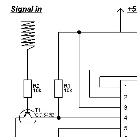

Hi everyone. My name is Marco Santos, i from Portugal and i need some advices.
I'll need to get the signal from the spark plug wire to build a tachometer. The max rpm is 21000 rpm but the system is to work with 2 cycle engine and 4 cycle engine.
All the help is welcome.

I do not know about best but most of the ones I have seen look like this.
I do not have any experience using it. I seem to remember that there is about 8 turns of wire around the coil or spark plug wire in this sort of setup.
R1 is a pullup resistor that keeps the uC input high. When the base of T1 picks up a signal T1 conducts and grounds out the uC input pin.
EDIT: The schematic was collect some time back. I do not know where it came from but it is simple enough that the author should not mind. If you are he and you do it can be removed.
Since 2 cycle cylinders fire every revolution and 4 cycle fire every other revolution, you will need a switch to select which type of engine the tachometer is connected to.
A hall effect sensor around a spark plug wire would work, but most new cars use a crank position sensor to tell how fast it is going around (which you can derive RPM from)

Thank you for your time, the first idea i had was the hall sensor. But a friend told me to do it with a magnetic/inductive pick-up. i Just want to make a system portable with the 2 engines. I Think its easy to do the change form 2 cycle to 4 cycle on software or with a switch.

While most 4-cycle engines fire every other revolution, as pointed out above, they also can work fine firing every revolution. It is common in smaller, high-rpm, 4-cycle engines to fire every cycle as it simplifies the coupling to the ignition.
Thus, you will need to be sure what the firing program is for your 4-cycle engine to get proper calibration.

Schematic from my frist post.
