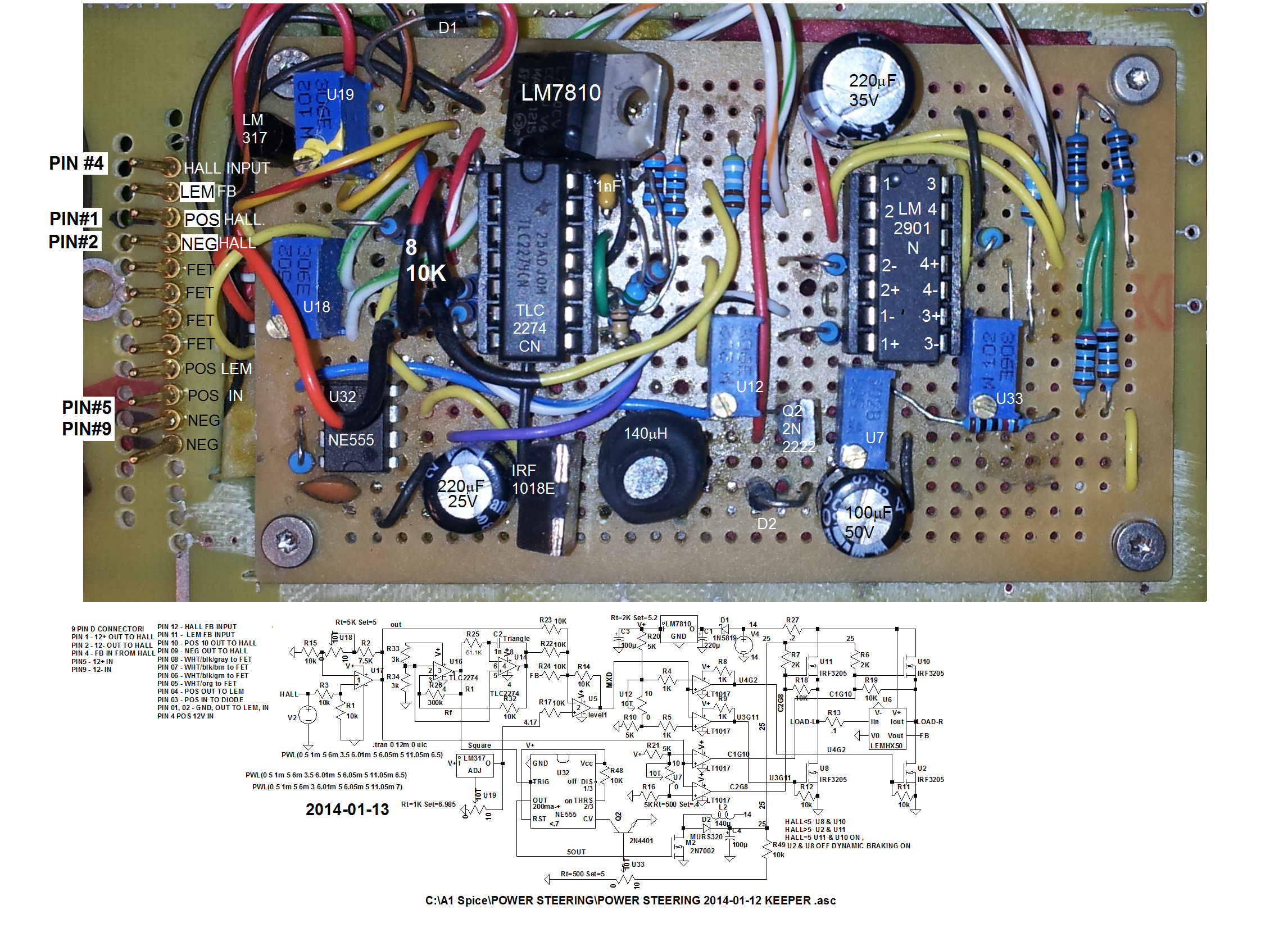

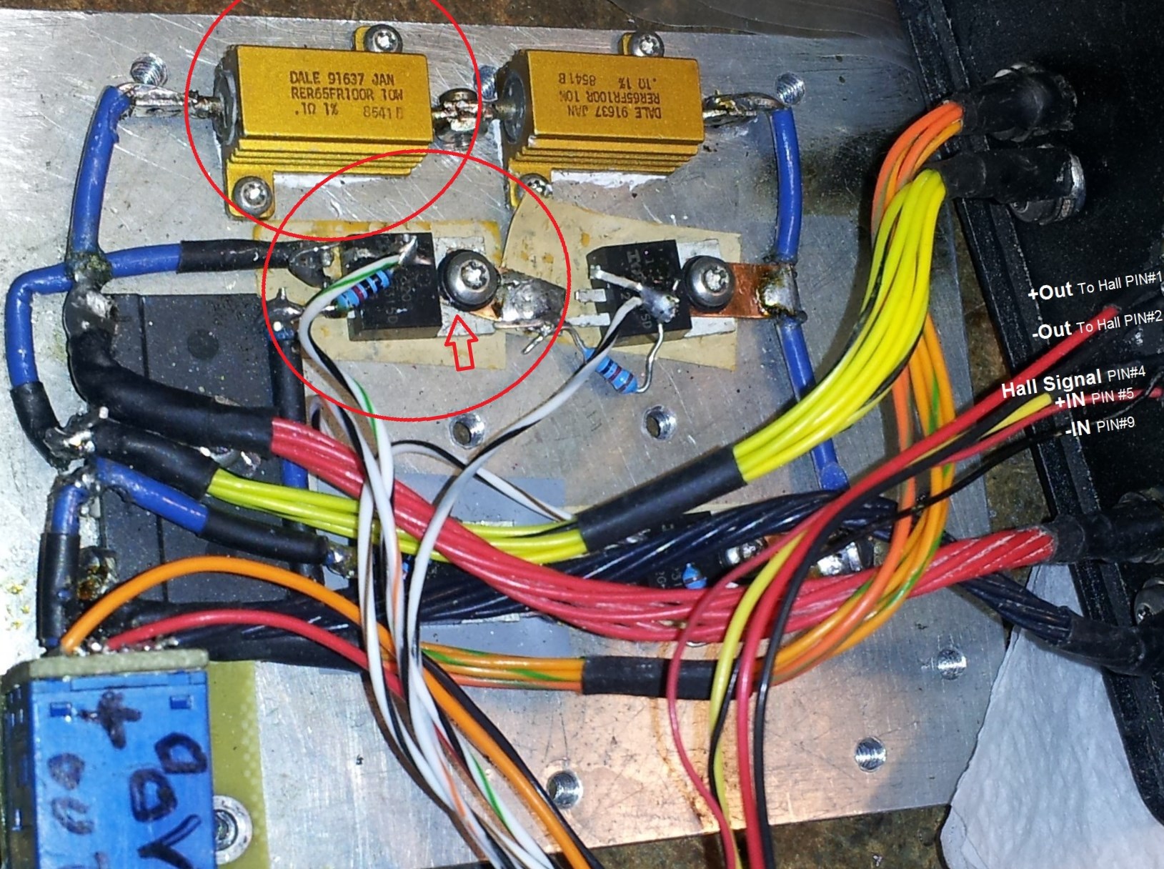

As requested and more, in the .jpg, the red circle are around failed items, the red arrow is the shoulder washer that melts. I forgot to take a photo after I replaced all the FETs . The 2 .1 ohm resistors were replaced with a 50 watt .1 ohm resistor, similar but larger. I doctored the .asc to help you understand the file. You won't have some of the components in your library, so you will have to add them.
The heat sink shown goes in an aluminum box that has fins mounted to it.
Spice say my frequency is 11kHz, I was thinking it was closer to 20, I pull it out and measure and photo it, may take a day or 2 tho.
EDIT, made a few changes to the .asc file

The IRF3205 has a gate charge of 146nC, which is fairly large. That capacitance driven from your 2K pull up resistor is a very slow combination. So your mosfets are spending to much time in their linear mode, not fully on or off. This makes them run hotter than they would if the turn on time was much faster.
You really need a higher current to driver the gates up and down more quickly. You can make one with a couple of BJTs, or use a gate driver IC. I'm using a Fairchild FAN7842 in a product of mine. A pair of those would do well for your application. Also, since they have their own charge pump, you don't need to generate the +25V for the highside mosfets.
According to the Data Sheet, The IRF3205 Requires 10 Volts Gate to Drain, to Fully Turn On.
Since your Supply Voltage is Just 10 Volts, It is Unlikely the LT1017 will deliver that 10 Volts.
So you Won't get a FULL TURN-ON, on the Mosfet.
Also you should have a Gate Resistor of about 75 Ohms between the LT1017 and the Gate of the Mosfet for best performance.
After reviewing the other replies and your last reply to my previous reply i have come to the same conclusion as other readers here. That is that the gate is not being driven correctly. To get the MOSFET in a PWM application to dissipate low power you need at least two things: 1. Enough gate voltage, and 2. Enough gate current.
Most of the time we have the correct gate voltage (5 or 10 volts or whatever) but many times the current is not high enough to turn the MOSFET on and off fast enough. IF the MOSFET switches too slow then the power dissipation goes wayyyy up and heats up the transistor too much. That means a good gate driver scheme is required. This could be a MOSFET driver IC chip which can put out 1 amp or more or sometimes we can get away with a two transistor driver using one PNP and one NPN transistor both as voltage followers with the emitters tied together.
The switching MOSFET is at it's best when it is either fully on or fully off, because both of these states means very low power is being dissipated in the device itself. If fully on it passes lots of current but has little voltage drop, and if fully off it has lots of voltage across it but little current through it, and both of these states means the power P=I*E is low because either I or E is low.
The problem is that when the MOSFET first starts to turn on the drain provides some feedback to the gate through the gate-drain capacitance, and that acts to decrease the gate drive voltage (negative feedback) which looks like a tiny 'step' in the voltage when it should be going straight up to the max gate voltage. During this time the MOSFET is neither on nor off completely and that means lots of power heating. To make this time as short as possible a low impedance drive is necessary and this usually has to come from an active driver circuit. IC's have been designed just for this purpose and so that is a pretty good idea, or you can try the dual transistor follower scheme to see if that works ok first.
Another interesting thing to note is that the gate does not take too long to pull high (or low) when there is enough drive current available. That means the driver chip only has to put out a high current for the time that i takes to actually change the state of the gate. After that, the driver only has to put out a small current (perhaps microamps) to keep the gate at that state. So for say a 1ms gate pulse the higher 1 amp current might only flow for 10 to 100us and after that the driver just has to 'keep' the gate high and that takes little or no current.

Well spoke Mr Al and I agree, I shall add totems first to the PWM, low side, high side is strictly an on off affair while the low side does the PWM and it is the low side FETs that have failed.
A minor point is that Spice works better with models from Linear than some of the other sources, so I use models supplied with Spice, the LT1017 is actually an LM2901N
chemelec, the triangle wave mid point is varied by mixing with the input from the Hall and is compared to one of 2 set points to produce the on off times for the PWM, the out put of the LM2901N comparator is the source of the square wave. Do you have an explanation of how you use the 555 as a driver?

ps use physically larger fets if you can because it's easier to get heat out of them, paralleling them also works very well as your I2R losses overall are halved and the power is spread across 2 devices. much easyer.
one psu I made had 24 fets in parallel at high frequencies and it works just fine ;)
Chemelc, Yes, this circuit is for a power steering assist and at rest and normal straight driving, the motor is turned into a dynamic brake to resist bump steering.
Another tidbit of information is probably of little concern is that when the FETs were destroyed, I was testing them to see if they would fail, the OHV has 4 wheel drive and the differentials can be locked and when turning, there is a terrific bind and this causes the steering to try to go straight and requires a lot of power to counter act. Turning the wheels to full left or right is virtually impossible on pavement, but on sand or dirt, just hard.

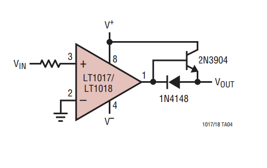

While checking the spec sheets of the LM2901n and LT1017, I noticed this application,(see attached) and I will modify my circuit to include it.
OK, But V+ Need to be Higher than 10 Volts.
Transistors,typically have a 0.6 volt drop.
So 11 or 12 Volts would be Better.

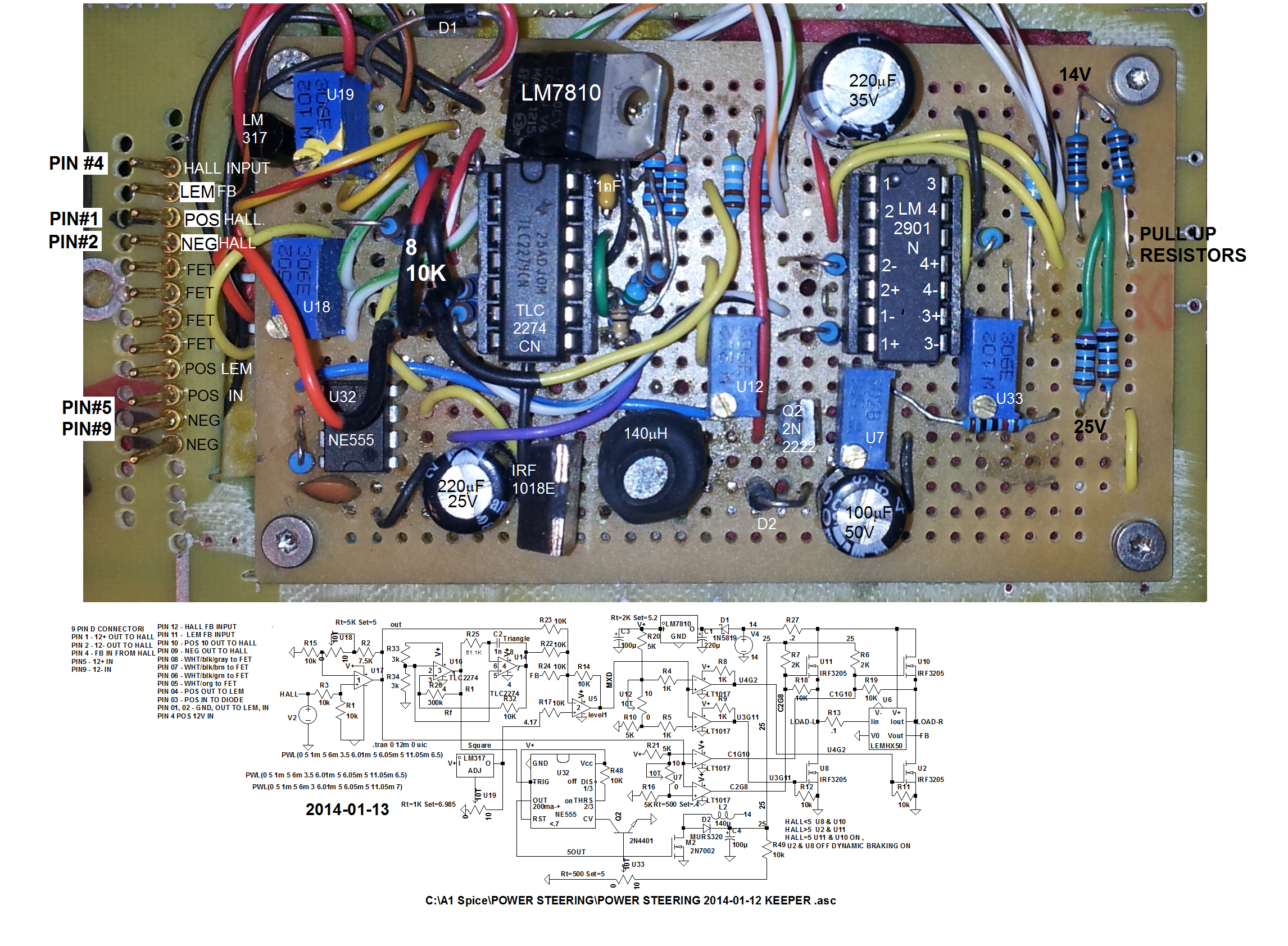

my frequency is 43KHz
I have to stay with a 10v V+ because of the hall effect device, but the pull up resistors are tied to 14 v or 25 v

How many times do we have to say it, you cannot drive a mosfet fast using a pullup resistor. You need a proper driver to get this working without overheating, even a simple bjt complementary buffer will be better than this.
The gate capacitance of that mosfet is 3.3nF and for purposes of gate switching it will act even a little bit worse.

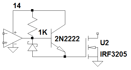

I'm not sure what your saying here, I'm changing the drivers from simple pull up to a transistor with a schottky "pull down" as shown in the uploaded file.
The LM2901N, National, has a response time of 1.3us which is much faster than the 43KHz of this circuit

Sorry I was looking at the schematic you shown in the last post, and saw the same comparator configuration as before, just with 1k instead of 2k.
This way it looks it should work reasonably well.
