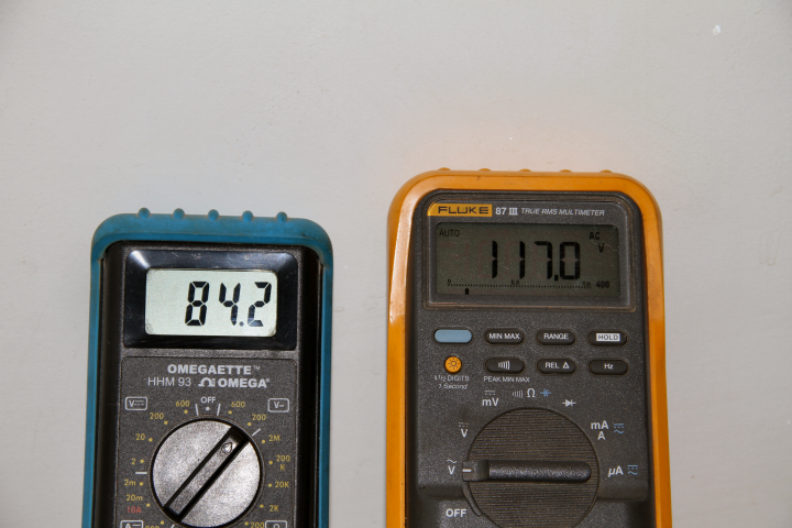

Both meters are connected to the same source, a UPS Power Supply US standard 120 VAC 60 Hz. The output is MSW (Modified Sine Wave) so note how only the meter on the right presents a correct value of about 117 VAC. The meter on the laft, an inexpensive meter, responds to and displays the average value. The AC response may or may not effect your choice.

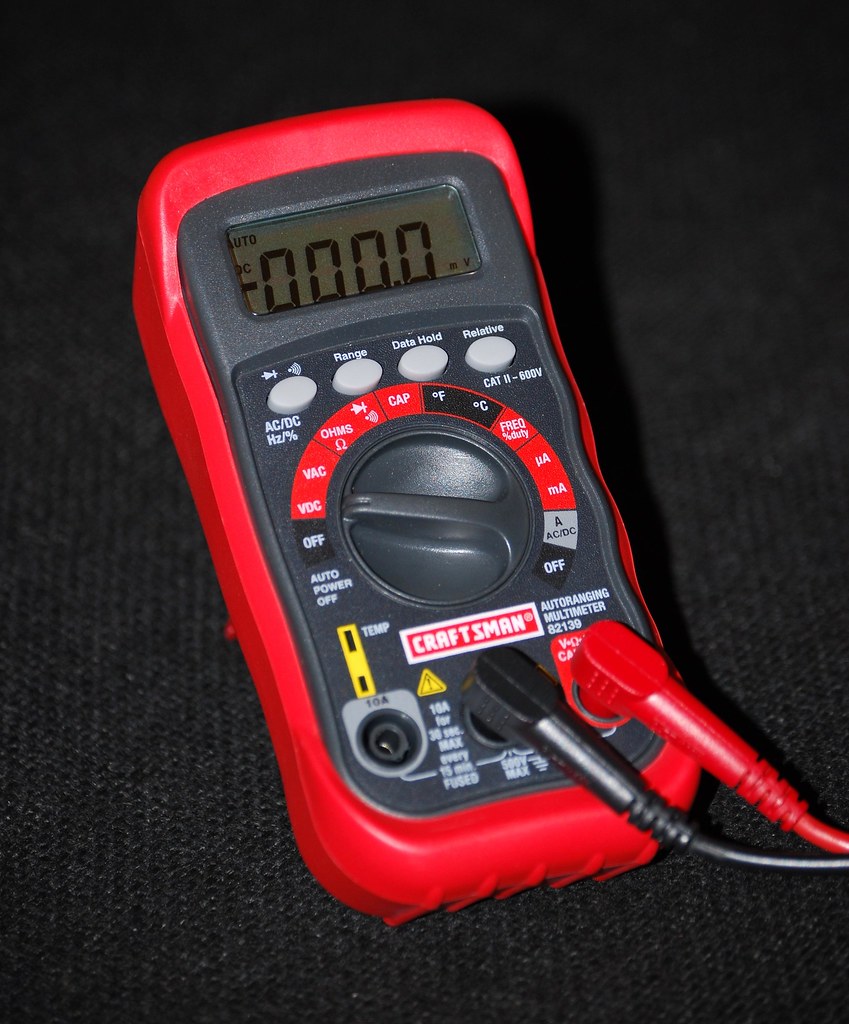

I bought a $25 Craftsman from Kmart almost 9 years ago and it's still going strong. I was surprised it worked so well.

How'd you get my meter? :)
That's amazing, i have the very same make and model. Got mine directly from Sears in Watchung, NJ. See attachment.
I must have about 20 meters. Of them i used that Craftsman one the most because it is small and easy to grab for a quick test. It also reads up to a count of 3999 rather than the usual 1999 which helps get better resolution readings. It also has a 'relative' mode which helps when you want to read the difference between one reading and the next several rather than an absolute measurement.
