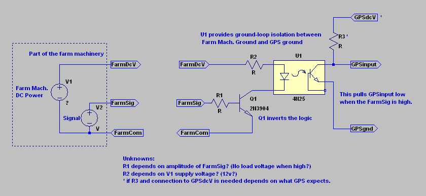

Relay is a poor way to invert the signal. If you were going to use a relay, why do you also need an opto-isolator. Do you need to isolate at all, or just invert the logic?
Lets see if you can answer this: If the signal out of the farm equipment is high (a few volts positive measured with respect to some ground wire in the farm equipment, do you want the GPS input to be pulled low?
You own a multimeter? If so, go make some basic measurements to answer the questions posed above and in the attached diagram.

[/QUOTE]You own a multimeter? If so, go make some basic measurements to answer the questions posed above and in the attached diagram.[/QUOTE]
The machinery diagram is spot on
When high it has got voltage & low no voltage (12v)
V1 is 12V

Hi Tim,
Sorry, I got busy, and haven't replied.
First, do you have a manual on the GPS? If it is like the one in my brother-inlaw's big tractor, then it came with a manual that is about 500 pages long...
In it there will be a section on interfacing sensors to it. It should tell you what it expects as an input high logic level, usually >3V, but it may have a "not to exceed" voltage level. It may also say something like "relay input" or "active pull down".
It will also answer the question as to if "optical isolation" or "relay isolation" is really required.
If "isolation" is not a requirement, but a logic inversion between your sensor and the GPS is required, then a simple switching transistor used as an inverter will do the job. We still need to know if the inverter requires a "pull-up" resistor, or not. If it does, we also need to know what supply voltage the top of the pull-up resistor must be connected to? If the GPS needs the external logic to drive a positive current into the input to get a logic high, then it might output that supply voltage on another pin in the interface connector. That would be listed in the manual, too.
Can you scan an post the interface connector and specs on here?

My GPS is Trimble and all I have is the User manual however I put together a circuit based on your diagram. I played around with resistors and ended up with a 220 ohm on anode pin 1
I have tested the circuit and it works fine.
