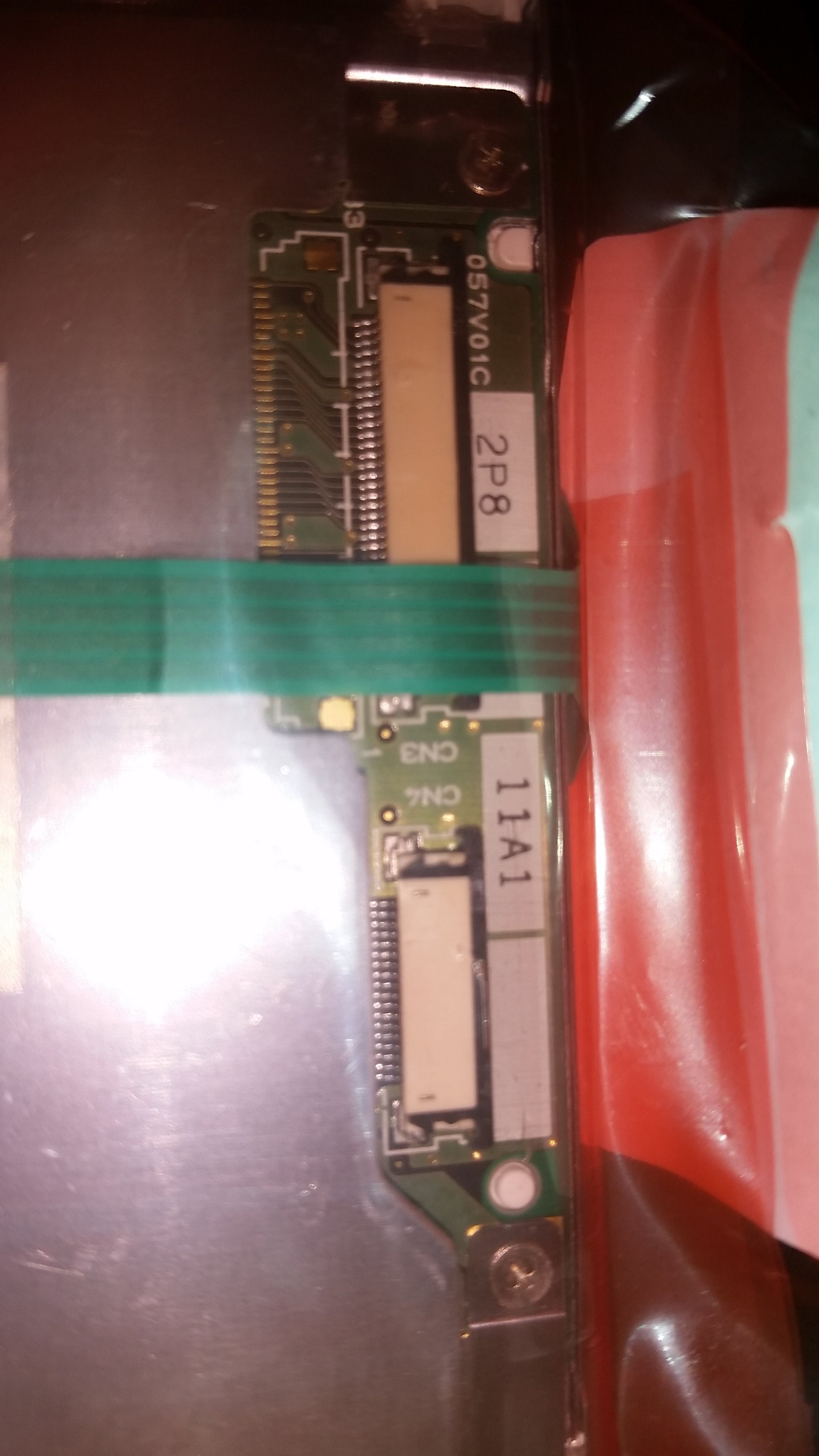

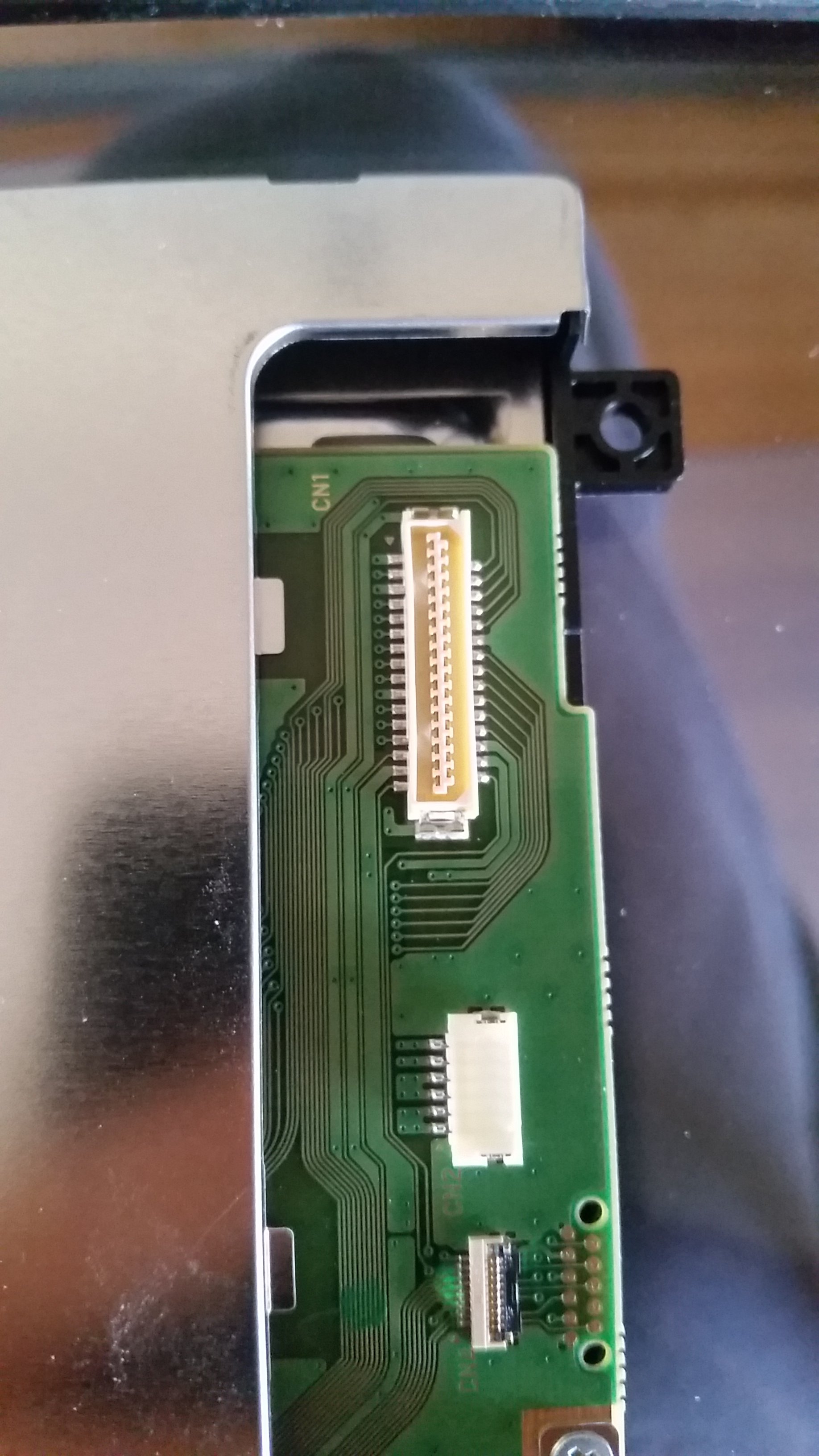

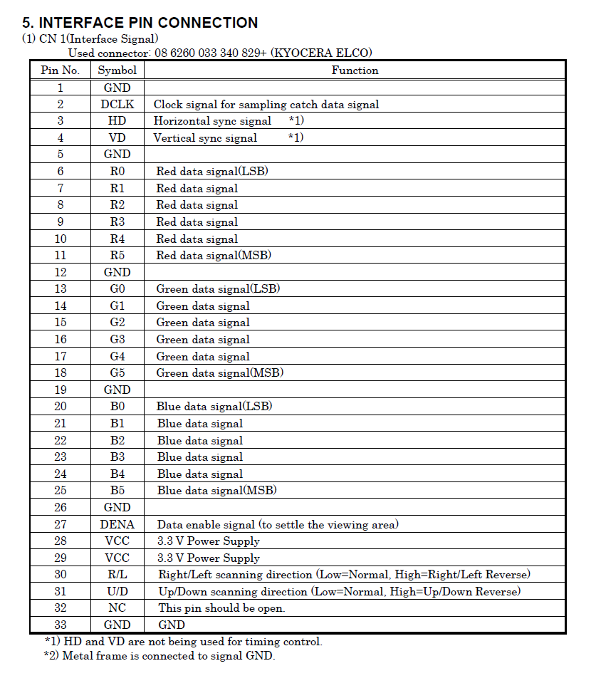

Hi, I've been purchasing some LCDs for a project I'm doing and I encountered a strange contact on one of the displays. I know what the DF9 contacts are as can be seen in the first image, however, the contacts in the 2nd and 3rd image are strange, any idea what they are?
