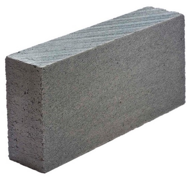

Hi, Thanks for the replies.
The blocks are the standard 4-inch masonry blocks commonly used for building houses in the UK and Ireland (see pic). They measure 4 x 8 x 17 inches approx. and are solid (meaning no internal air cavity) and do not contain any metal. They are made from small stones bonded together with cement.
The wall I am referring to is the wall between the two adjoining houses in a demi-detached block, not internal walls within one house.
My living room and my neighbours living room are separated by just this wall.
What I am seeing is that the WiFi signal strength in my living room from the neighbours WiFi is roughly the same as from my own WiFi router, located in the same room! I was expecting a much lower level from the neighbours WiFi, given the wall construction method.

I used Netspot on a laptop to measure the WiFi signal strength. The laptop was positioned about 8 feet from the WiFi router. I am reading about -45dBm from my own router but about -47dBm from my neighbours WiFi. So only about 2dBm difference. I was expecting much more attenuation than this, as the block wall is at least 8-inches thick. I believe both routers are the same type, being supplied by the same TV and Broadband provider (SKY TV). Also the house is two-story, so the wall is quite high.

Also, the building blocks are likely "Aerated concrete", a low density material rather than literal solid concrete - eg.
Yes, the 440 x 215 x 100mm Aerated blocks you mention look like the type used in the wall construction alright. The size is the same too. Despite not being made of solid concrete, I was expecting more than 2dBm of attenuation through an 8-inch wall made of this material.
The nearest figure I have seen browsing the internet is 11dB attenuation for an 8-inch concrete block with hollow cavities inside at 2GHz. I would expect more than this for 8-inches of block with no internal cavity at 2.4GHz. So I'm still puzzled.

I suspect it is down to moisture content, and the blocks being aerated (~1/3rd the density of solid concrete).

If your blocks are flat, then, as they are around 1/3rd the density of solid concrete, the attenuation (not structural strength) should be equivalent to ~66mm dry concrete.
