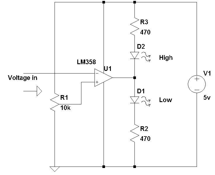

The input to the circuit is a temperature readout from a thermometer or temperature sensor. I guess you could think of the temperature as a voltage (?). When the temperature is above a particular point, I want a first high voltage light to be on and a second high voltage light to be off. When the temperature is below that particular point, I want the first light to be off and the second light to be on.
You can use an opamp as a comparator & drive the LEDs from the output. The set point is adjusted via the pot, R1.

Thanks! That was fast! What software allowed you to draw that so nice and fast?
The only change I have to make is that lights are not LEDs, but rather are regular lights. I'm not sure how exactly the circuit would look for that. I know that's super basic, but I haven't designed a circuit in about 20 years.

The rest isn't that difficult. I would think about a comparator circuit to drive a simple relay configuration. I would use a DPDT relay with contacts rated to handle the lamps. Temperature exceeds setpoint and lamp A is on with lamp B off. Temperature below setpoint and lamp B is on with lamp A off. I believe that is what you are after? I would add some hysteresis likely in the comparator circuit so the relay isn't freakig out as the temp hovers around setpoint.

Lights, as in 120V light bulbs? What wattage?
The lights are 120V light bulbs and 100W or more.

I don't yet have the temperature sensor. I'm thinking the sensor will be a laser thermometer but could easily be something else. The temperature range is about 0F to 100F. The "particular point" is about 50F or so. Your re-wording of my description is correct.
