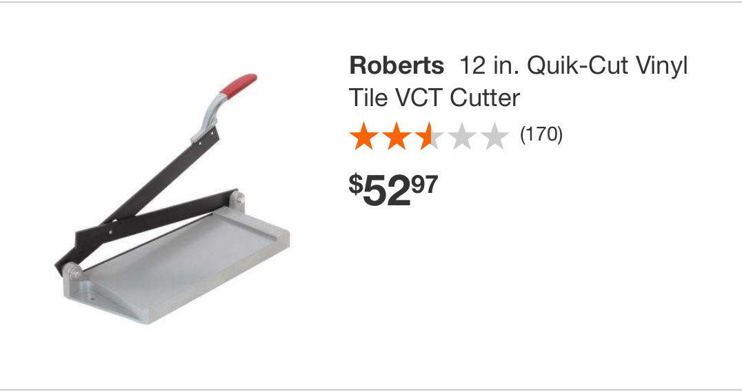

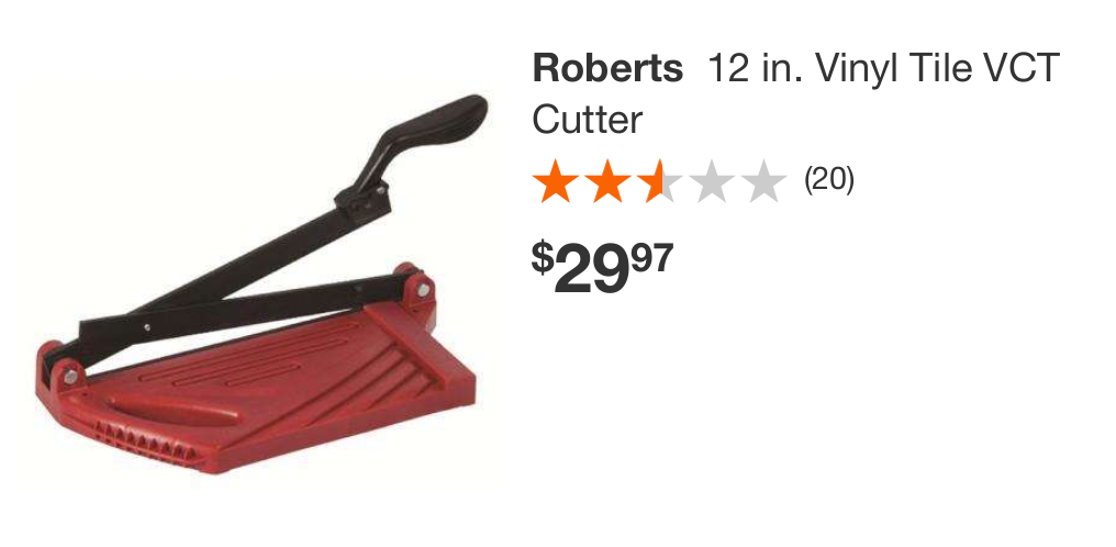

Tile shears for floor tile, like a paper cutter on steroids, make for pretty decent cuts. Here are a couple that Home Depot has; I have one similar to the gray one.
