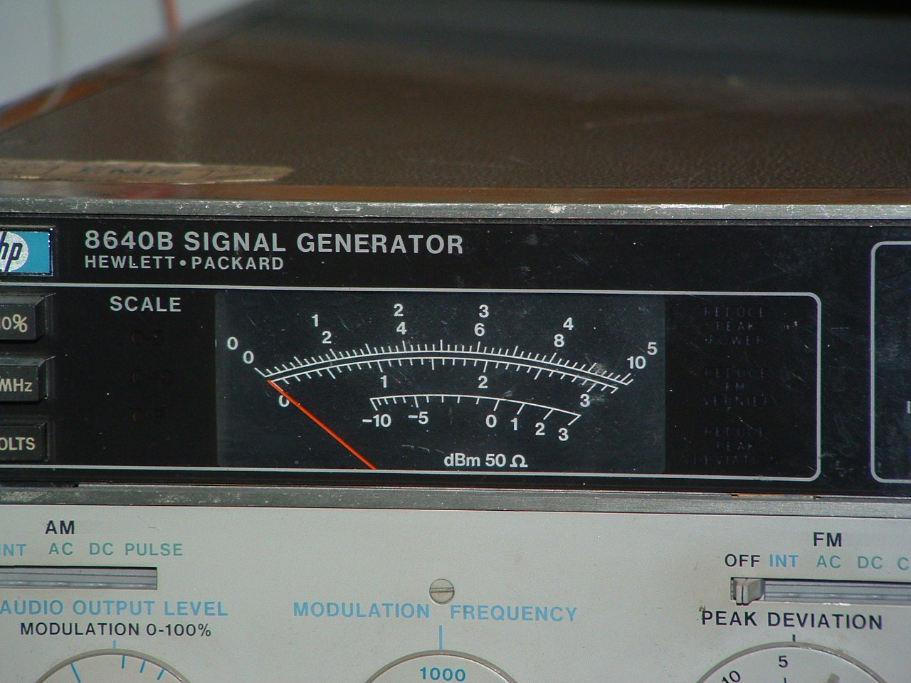

I beg to differ and state that most RF equipment uses 0dBm as 1mW in 50 ohm.
I support of this statement, I offer examples from an RF Signal generator type Hewlett Packard HP8640B.
Look at the attachments, a scan of a part page from the specifications in the maintenance manual and a photo of the meter on the front panel of the generator.

I agree with JimB about the RF.
My experience is that dBm is just dB referenced to 1 mW irrespective of the details. Obviously, measurement equipment designed for a particular purpose might have additional requirements, but the definition is a simple power reference.
For example, I used to work in the optical communications field and dBm is used extensively there. Optical power measurements is often based on photodiode or thermopile measurements and impedance is not relevant in the measurement process. Still, the power is just the power and dBm readings tell you the power.
