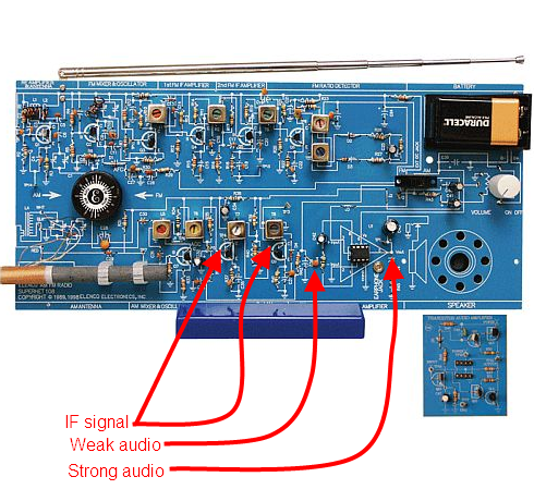

Here is a learning kit radio. The top half is FM and the bottom is AM.
"IF" is intermediate frequency. One of the pins on the metal can should have 455khz with audio. You might see it on the Collector pin of the transistor. (very small signal)

wow, that's a pretty cool kit. i ought to get one for my youngest son. who makes that?
one way to see what's going on in RF and IF circuits is to feed an AM signal from a signal generator. i think most oscopes will be able to see a 100uV signal. so that would allow you to trace the signal all the way through from RF input to audio output. another often used test point would be the local oscillator output

very nice. i get the idea that the jumper wires in various parts of the circuit are for simulating faults? watch out for the speaker frame... it's been my experience that when the speaker has a field coil, the frame is at B+ potential.
